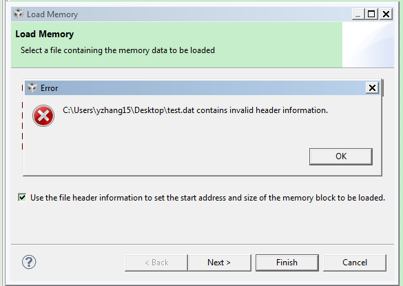

Hello:
  I encountered a problem others might frequently meet:
  I generated five digits [1 2 3 4 5] from matlab and export it as dat file:
This dat file looks like this in my desktop.
Then I listened to technician's suggestion and use "load memory" in debug perspective to choose this test.dat file in my desktop
and I want to load these five digits into consecutive memory address starting from 0x80000000.
However, I got stuck by two problems:
1-I have heard that I should use "CCS.dat" format rather than generic .dat format generated by matlab.   How could I make sure I am loading in CCS.dat format data?  And should I chick on "Use the file header inform...."
2-When I hit "Next", warning  poped up:
Could anybody give me some hints about :
Why it happens?
How could I validly import generic dat file into my memory via "load memory"?
And how to convert into "CCS.dat" file?
Thanks a lot
Yu
  • Yu,
    .dat files from Matlab and from CCS differ in format. One way to find out its format is to check the CCS Help --> Help Contents: search for "data file formats".
    This document had a bug that is reported on the thread below, but I am unsure if they have fixed it. For details check:
    e2e.ti.com/.../277303
    Hope this helps,
    Rafael
