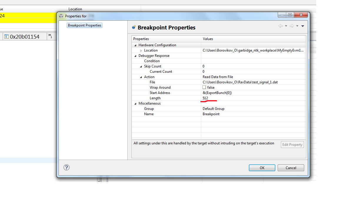

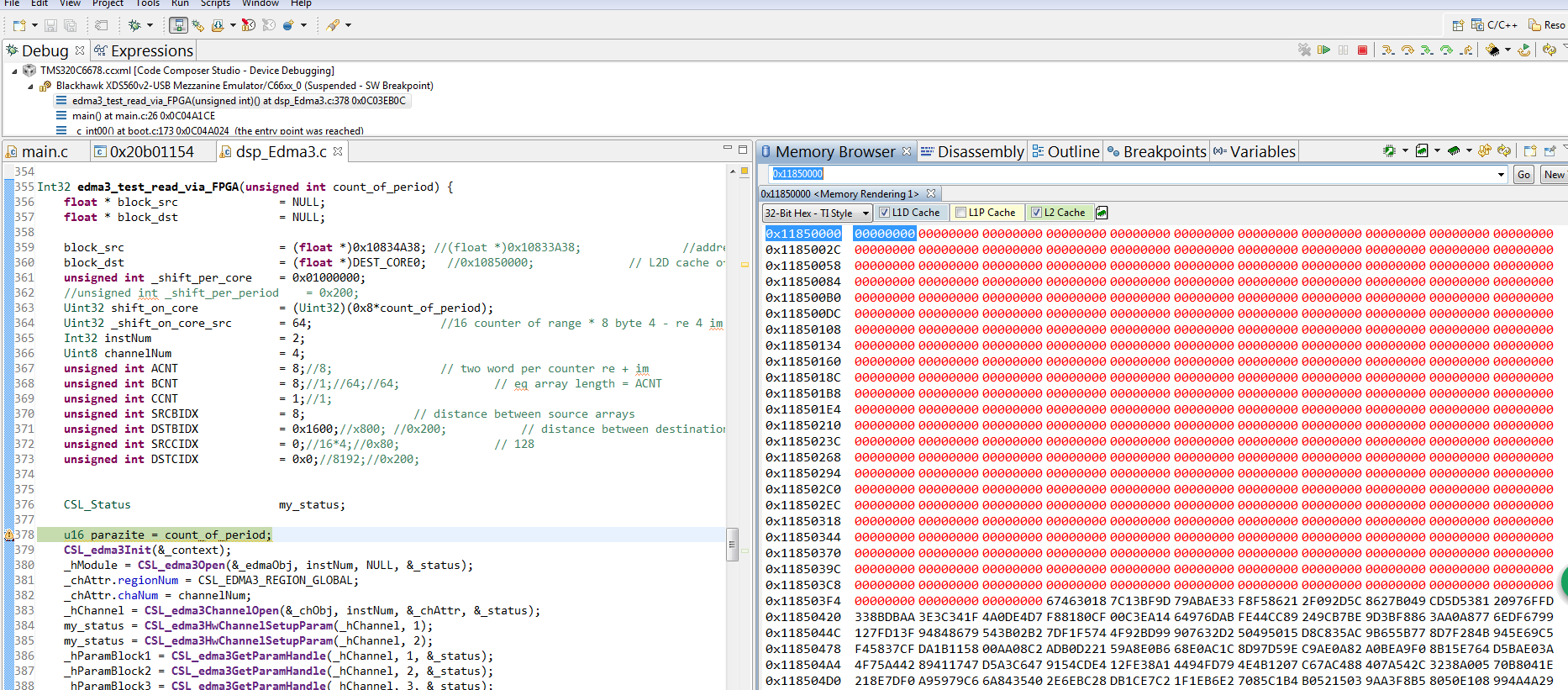

I use CCSv5.2 and TMS320C6678. I tried to use breakpoint with Action Read Data From file. My breakpoint properties is
Memory state before
Memory state after
Array is
Attemp read writing file
Open test read writing file SUCCESSFULY
Quantity read float is: 37
fl[ ]= 0.00 fl[ 1]= 0.00 fl[ 2]= 5.58 fl[ 3]= 10.96 fl[ 4]= -7.03 fl[ 5]= 0.19 fl[ 6]= -2.78 fl[ 7]= 0.42
fl[ 8]= -3.18 fl[ 9]= 8.25 fl[10]= 2.75 fl[11]= 27.26 fl[12]= 11.96 fl[13]= 48.01 fl[14]= -5.84 fl[15]= 27.99
fl[16]= -40.41 fl[17]= 6.80 fl[18]= -37.04 fl[19]= 24.90 fl[20]= -10.93 fl[21]= 23.43 fl[22]= -18.15 fl[23]= 5.31
fl[24]= -10.83 fl[25]= 13.98 fl[26]= -27.27 fl[27]= 23.93 fl[28]= -32.25 fl[29]= 2.99 fl[30]= -16.50 fl[31]= -6.97
fl[32]= -24.29 fl[33]= -3.39 fl[34]= -16.67 fl[35]= -13.77 fl[36]= -20.34
End Test Read Writing File
Where I was wrong?
      Oleg

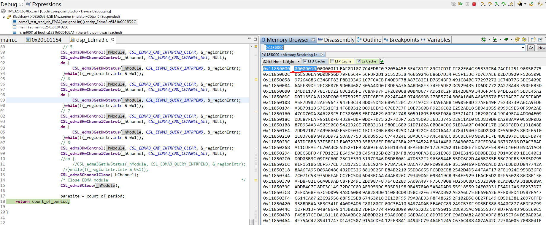

  • I tried to write to memory does not active core - but result identical
    I tried to write to DDR3 memory - absolutely idem
    It not connected with possibility write to this memory via JTAG - underlined in red - my edit via JTAG
    Why is it so? Where my error?

    I did the following:
    I inserted to .cfg file next lines
    var LoggingSetup = xdc.useModule('ti.uia.sysbios.LoggingSetup');
    LoggingSetup.eventUploadMode = LoggingSetup.UploadMode_JTAGRUNMODE;

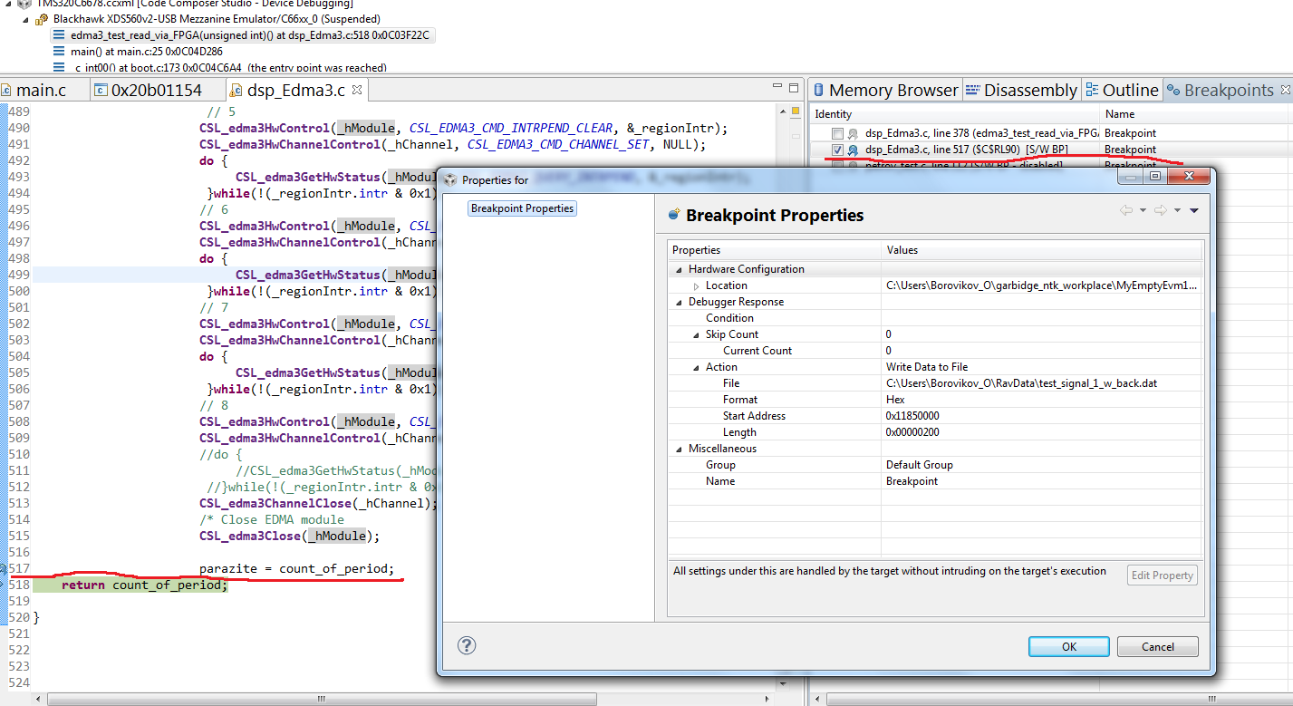

    and created first breakpoint as is
    I created the second breakpoint - with Action-> Write Data to File
    Memory Brouser after breakpoint
    red underline is result action my api
    The file before action is empty, and after action his dump is
    1651 1 11850000 0 800 0                         // I don't know what is it

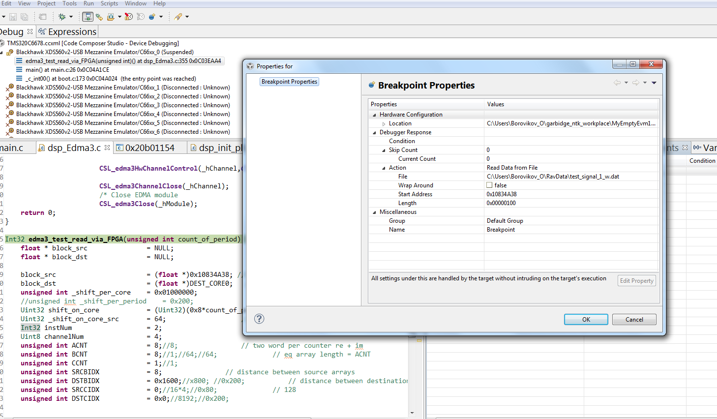

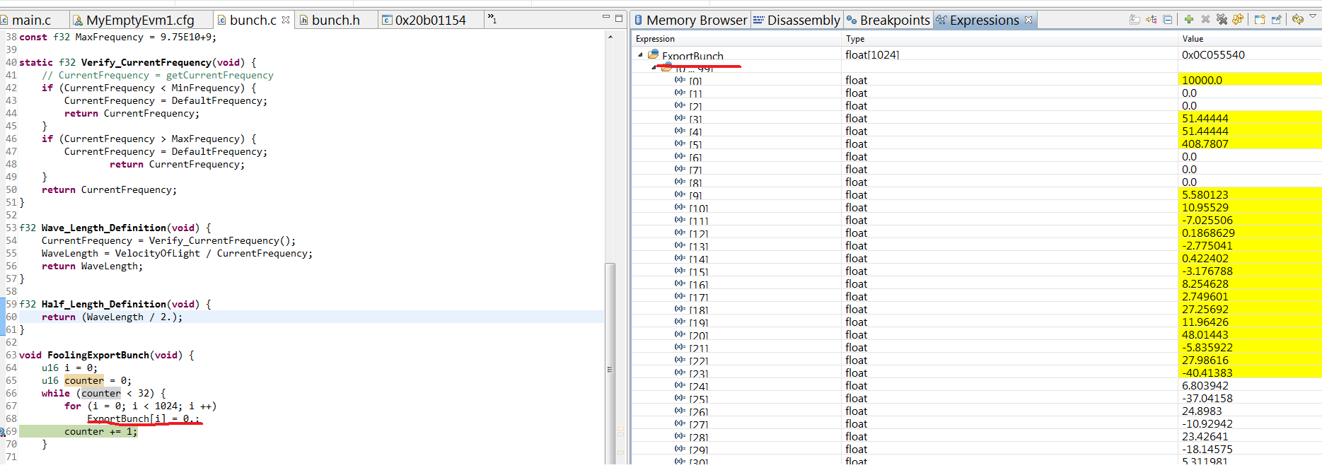

  • Hi All,
    I was able to Read and Write File into breakpoint -> Action.
    My breakpoint is
    red underline length - it should decimal int without prior zeros
    and data file format is text, one number - one line as it
    1.000000e+04
    0.000000e+00
    0.000000e+00
    5.144444e+01
    5.144444e+01
    4.087807e+02
    0.000000e+00
    0.000000e+00
    0.000000e+00
    5.580123e+00
    1.095529e+01
    -7.025506e+00
    1.868629e-01
    and result action is
    at any rate so happened with me
    Best regards
