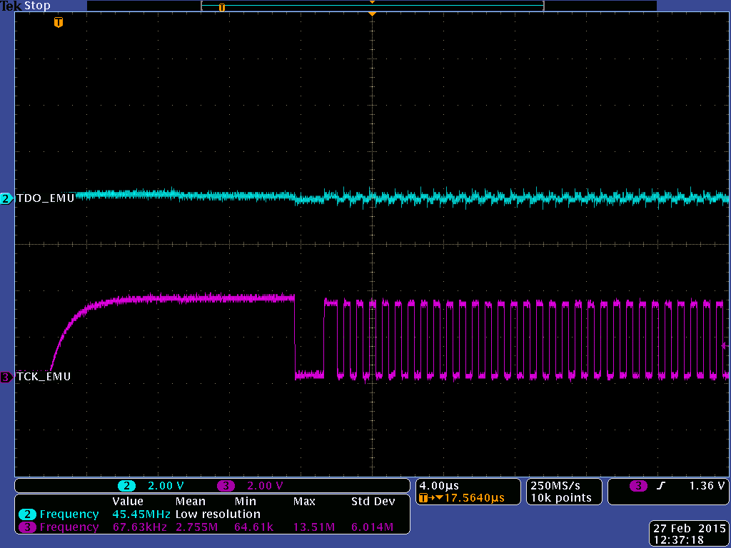

I've to connect XDS-200 emulator to a tiva-C series ARM Cortex M4 microcontroller. The target side connector is ARM-10 and emulator side connector is TI-20. I connected TDI, TDO, TMS, TCK and nReset pins as specified. I've the following error received on Test Connection with CCS Studio.
[Start]
Execute the command:
%ccs_base%/common/uscif/dbgjtag -f %boarddatafile% -rv -o -S integrity
[Result]
-----[Print the board config pathname(s)]-----------------------------------
C:\Users\VVDNLT~1\AppData\Local\.TI\693494126\
0\0\BrdDat\testBoard.dat
-----[Print the reset-command software log-file]-----------------------------
This utility has selected a 560/2xx-class product.
This utility will load the program 'xds2xxu.out'.
The library build date was 'Aug 20 2013'.
The library build time was '23:33:52'.
The library package version is '5.1.232.0'.
The library component version is '35.34.40.0'.
The controller does not use a programmable FPGA.
The controller has a version number of '12' (0x0000000c).
The controller has an insertion length of '0' (0x00000000).
This utility will attempt to reset the controller.
This utility has successfully reset the controller.
-----[Print the reset-command hardware log-file]-----------------------------
This emulator does not create a reset log-file.
-----[An error has occurred and this utility has aborted]--------------------
This error is generated by TI's USCIF driver or utilities.
The value is '-235' (0xffffff15).
The title is 'SC_ERR_PATH_DR_BROKEN'.
The explanation is:
The data scan-path cannot circulate bits, it may be broken.
An attempt to scan the JTAG data registers has failed.
The target's JTAG data path appears to be broken
with a stuck-at-ones or stuck-at-zero fault.
[End]
I don't have external pull ups to TDI, TDO. Is that the problem. Else What?
