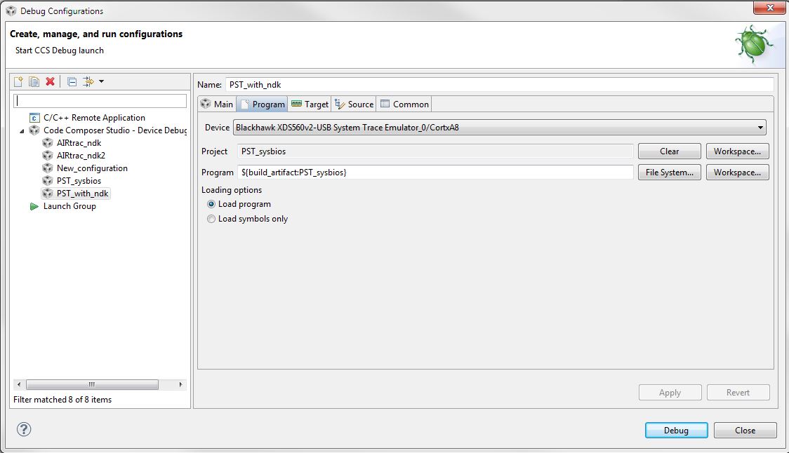

    I am debugging via the CCS Debug configuration:

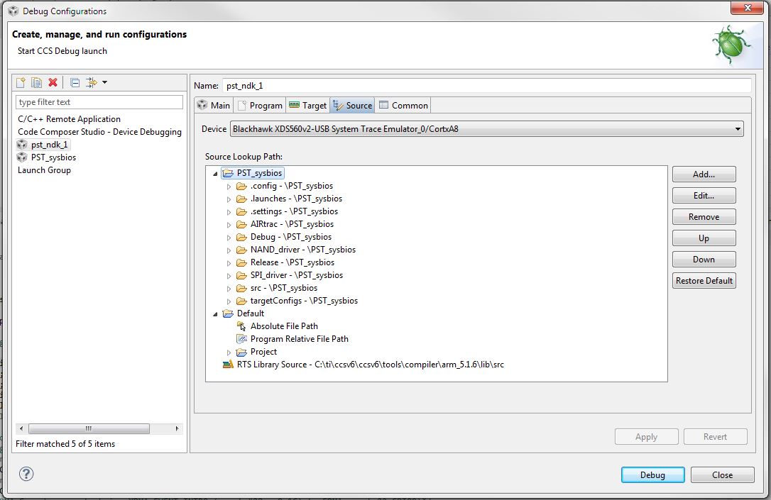

  • How are you setting up the debug source search path (how are you instructing the debugger where your source files are for source level debug)?
  • The debug setting are set in CCS->Run->Debug Configs. There is not an issue locating the source:
  • I am asking about source look up paths because they can have an impact in debugger performance. For example, if you are relying on source lookup paths in the "Source" tab of the Debug Configuration properties with "Search Subfolders"enabled, this can have a big impact if the directory specified has many subfolder with a lot of files.
  • The source path is just the default one which is pretty short.
  • Looks like you don't have any paths defined there.
    It does look like you have a project in the workspace that has all the source file added to it and that is how the debugger is finding all the source files. Please correct me if i am wrong.
    As a test, could you close all other windows/views except the debug view (ROV, etc) and try single stepping and see if that helps any?
