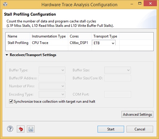

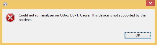

We are using TDA2xx SoC and XDS560v2 Pro Trace emulator. When I tried to do the Stall profiling forC66xx _DSP1, it gives error "Could not run analyzer on  c66xx_DSP1. Cause: This device is not supported by the receiver". Is it so?

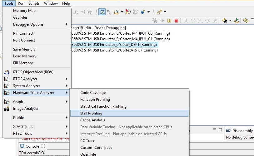

Even I am not able to do any functionality comes under Tools>Hardware Trace Analyzer in CCS.Also tried with XDS560v2 STM.
Please let me know the way to analyze the stall profiling on TDA

    Despite I don't have such board with me, can you send a screenshot of the Trace job setup dialog box? Perhaps something obvious may be missing.
    Rafael

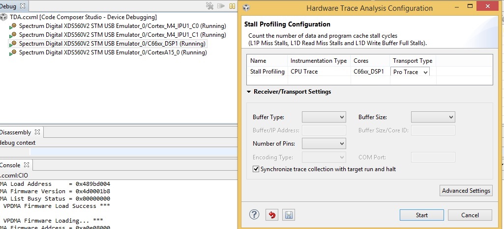

  • Hi Desouza
    Please see the log below from launching Target Configuration file to loading binaries to all cores

    Using Spectrum 560v2 STM >>>>>>
    Also getting same with Spectrum XDS560v2 Pro Trace emulator.

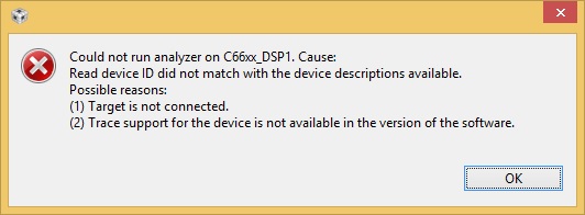

    Please correct me : Does Emulator needs device file? which is stored at installed directory "C:\ti\ccsv5\ccs_base\emulation\analysis\xmldb\trace_config\devices"
    If yes, then where should I get this file?
    Thanks.
  • In my last post the 2nd warning image comes, when I used ETB Transport
