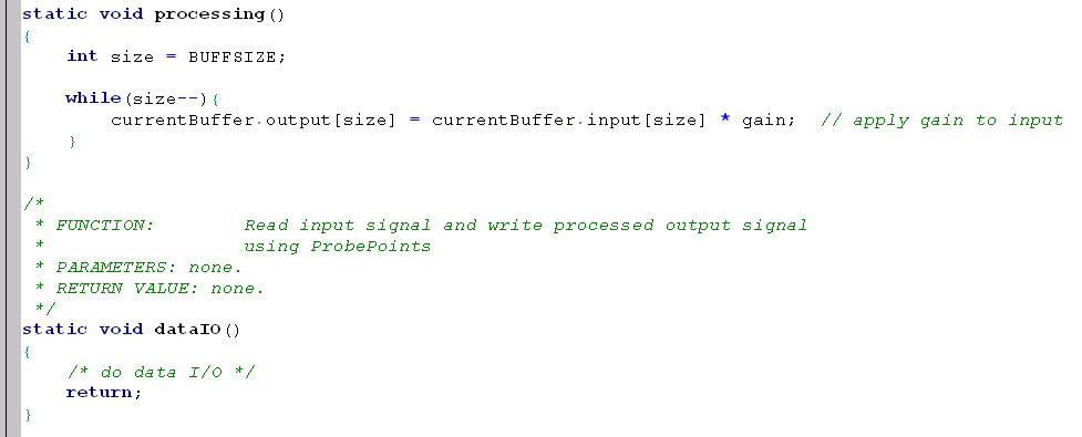

  • I am watching the tutorials for other devices, the closest device is 2407 and they are adding some header files (dsk2407.h) and adding linker and bios files. I do not have these files, how they get these? I am looking tutorials and for example in the code this "do the IO" part (on the screenshot), I do not know how to reach an IO or program IO as input or output. I am feeling like my brain going to explode, I cannot understand anything. Programming DSP is much harder than programming other hardware.
  • Keep looking at examples.  For instance the Software Test Bench has a regs240x.h that has a lot of the registers mapped for you.  That might be similar to "dsk2407.h".  Additional examples can be found in your Code Composer 3 installation, e.g. C:\CCStudio_v3.3\tutorial\dsk2407.  You can find example linker command files (.cmd) there.
    If you are unfamiliar with microcontrollers, that is a big topic.  You might review the reference guide for your device.  There you will find a memory map.  The way a lot of micros work are that the various peripherals are "memory mapped".  That is, there is some address (or multiple) that represents a peripheral, and can be used to program that peripheral.  Toggling one of the bit of a certain address might set a GPIO Pin high.  This is what files like "regs240x.h" assist you with, they give names to the addresses so it can be easier to understand what you are programming.
