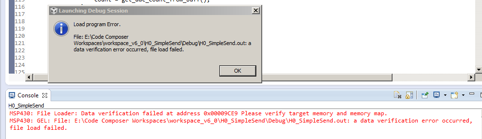

  •  If I set Full Verification I get the following error
  • Same problem with the standard library example "H0_SimpleSend" , just changed Target to F5510 instead of F5528
  • Also tried this on my other computer, running Windows XP. Same problem with TI HI_SimpleSend Demo. GEL File error.

  • After a few hours of working with the newer Code Composer 6.1 (MSP430) the dreaded GEL FILE error returning during DEBUG.
    Got to a point, I can't trust Code Composer will work reliably, and also frustrated with the slow speed. Will move back to my super fast and reliable Crossworks compiler.

    The problem is the loading of the source using SWB as the debug starts up. (GEL FILE error)
