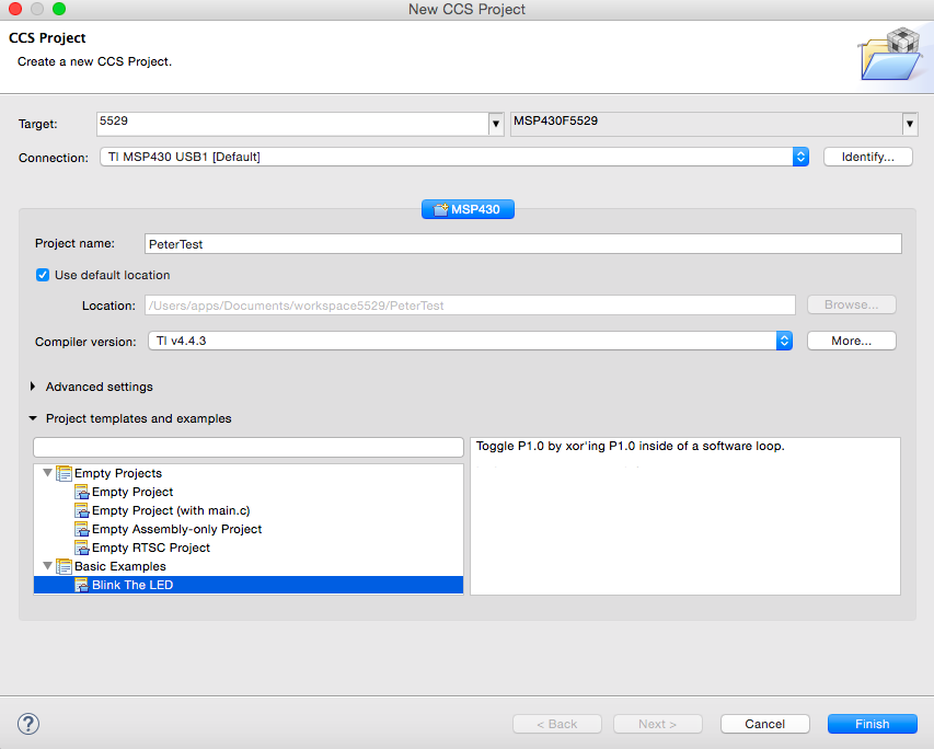

    In CCS if you go to the Project menu and select the "New CCS Project" menu item it will enable you to create a project for an MSP430 device.  The default debug connection will be the MSP FET (which will work for the standalone FET as well as the one built onto the 5529 LaunchPad).  Once you have created the project, clicking on the bug button will build it, launch the debugger, connect to the device, flash the program and run to main().
    Try filling out the project wizard so it looks like the capture below, then click finish and the click the bug button:
    John
