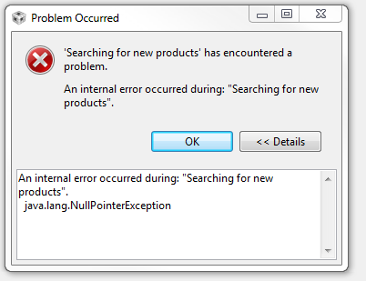

The auto update flagged that an update was available and clicked it to proceed. After update restarted CCSV6 and got the following error:
I had 4 projects in the workspace and all are empty. I loaded in another workspace and all those projects are empty.
If I right click the project the context menu is empty or missing items and if I click again they show up slowly. the main menu bar seems okay.
If I goto "Help\check for software updates" I get an info window stating: "Cannot complete the request. This installation has not been configured properly for software updates. See the error log for details."
In CCS installation details the Installed Software tab is empty, installation History gives an error message similar to above picture:
"An internal error occurred during: "Fetching Elements".
java.lang.NullPointerException"

I've also tried closing all programs and rebooting the computer. nada!
  • Keith,
    I apologize for the delayed reply and sorry to hear about your troubles with CCS.
    Could you zip up and attach all install_logs folders in the \ccsv6 directory of your installation? We could take a look to see if it gives any indication of why the update process failed?
    Have you tried opening a new, clean workspace and importing your projects into it to see if that works?
