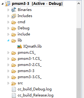

hi:
I want to import CCS3,3 projiects . into CCS6. but it isn't show all file like in CCS3.3 like. some c file is losted.
some one can tell me this option's detail?

  • thanks Mark:
    I looked that post.  and I success migrated CCS3 's project ,  when I build , there are warning :

    which place need my configuration?
    thanks !
  • when I set "rts2800_ml" in" build properties " ->" runtime support libs", rebuild ,   the warnings decline to" 10 warnings"
    shows :

    specionly: IQmath Tables.cannot be determined .
    how can I resolve it ?

  • yanzhen fu said:
    #16002-D build attribute vendor section TI missing in "../lib/IQmath.lib<IQ24sinPU.obj>": compatibility cannot be determined pmsm3-3    C/C++ Problem
    #16002-D build attribute vendor section TI missing in "../lib/IQmath.lib<IQmathTables.obj>": compatibility cannot be determined pmsm3-3    C/C++ Problem
    As mentioned in your other post, this warning can be safely ignored.
