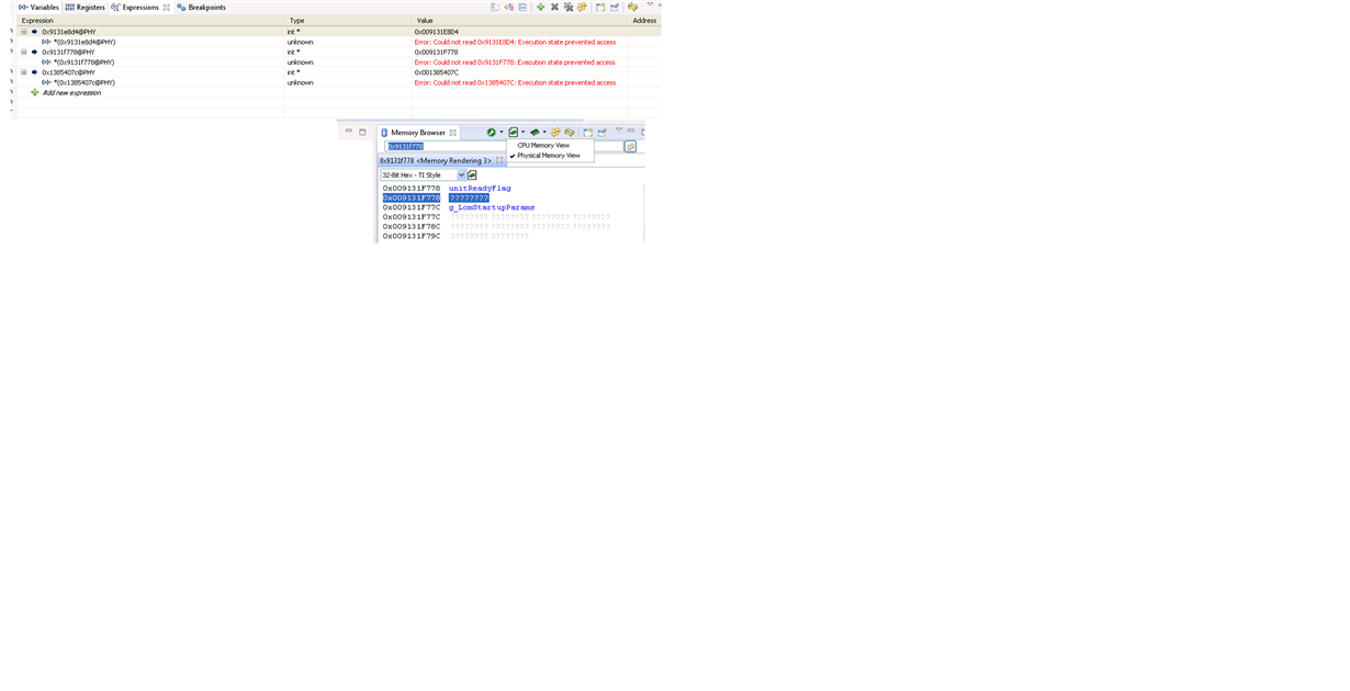

  • Hi,Rafael,
    thanks for your answer.
    I'm the condition 1).
    Application is already running.
    With CPU memory view, all are 0.
    With the physical memroy view, it seems not readable.(here for example,  unitReadyFlag is 1 actually)
    (seem the reply can not show the picture, pls see the attachment.)
    It's abormal, right? Is there any way (register) to debug this issue?

  • Hi, Rafael,
    Yes, the target is always connected with real time mode, for we are trying a function profiling test.
    The following snapshot shows the memory accessing from ccs are all 0, while from the our tool they are correct.
    thanks,
    Zhou
  • Zhou,
    I see the Memory Browser is displaying the CPU view and not physical view, which is probably what your application is accessing it. However, just as an additional test can you turn off the L2 cache option and see if that is not getting in the way of a proper display?
    Also, can you post picture of the entire CCS workspace? Basically this will help me see if there is anything obvious missing, be the status of the cores, the status of the real-time mode, etc.
    Rafael
