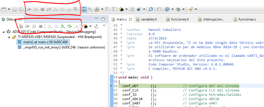

  • Hi everyone:
    I have the same problem, I did an update of the code composer studio ( Windows 8.1 x64) and now, some of the buttons are hidden
    I tried to change my project from Release to Debug, but that doesn't work.
    Which MSP430 device are you workng with? Would you be able to zip up your workspace folder and attach it here (or if you prefer you can send it to me via private conversation). Although couple of users have reported this type of issue after updating CCS, we have not been able to reproduce it locally, so it would really be very helpful to have something we can use to reproduce the issue.
    Also is there a particular sequence of steps you go through that consistently produces this issue with the debug buttons being grayed out?
    Your screen shot appears to show the same problem as others have seen with the "CCS Simple" perspective. See https://e2e.ti.com/support/development_tools/code_composer_studio/f/81/t/410823#pi316318=2 for a description of the problem and a work-around.
