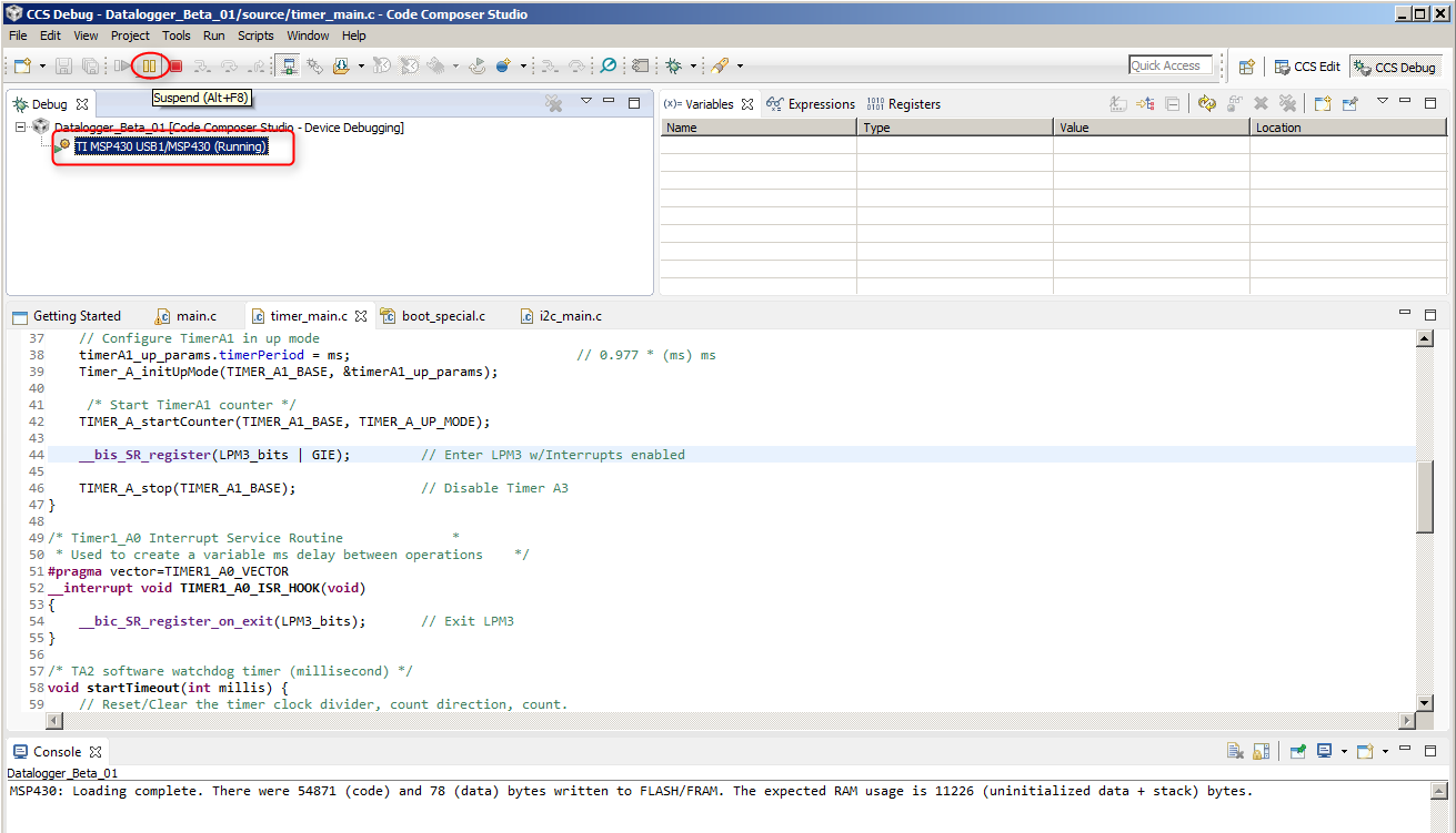

  • Ditto working with CCS 6.1 and an MSP430F5528.  I completely uninstalled CCS, reinstalled fresh - got ONE successful compile and flash and now it's totally broken again.  Can't run/resume, can't pause, can't do anything.
    6.0 worked fine.  6.1 is badly broken.

    I did find one more tidbit of detail though. The first compile/flash when I started up my computer worked. Then I disconnected and tried to flash again and I get the same hanging behavior again. It doesn't error - it just says "Loading Complete" in the console and looks like it works, but the Resume and Suspend buttons are greyed out and the only thing I can do is disconnect.
    This is literally holding up the show - I can't get any development work done w/o being able to resume the target. TI - please fix this ASAP!
  • I found a temporary work-around.
    If I flash the target, then click on the "Disconnect Target" button (also under Run -> Disconnect Target) then click on "Connect Target" suddenly my resume & pause functions come back.  I have to do this every time I flash which is very annoying, but at least I can keep working until this is fixed.

  • Hi Aarti,
    I just tried this exact sequence:
    1) Open CCS (this time I started in CCS Debug perspective, but usually I start in CCS Edit)
    2) Because I usually start in CCS Edit - I switched to that perspective first
    3) I clicked on the green "Debug" icon
    3) Target flashes ok, I'm now in "CCS Debug" perspective
    4) This time my "Resume" and "Suspend" buttons were greyed out on the first try.
    Before - I'd get one normal flash and "Resume" would be enabled
    I'd click on "Resume" then I'd always click on the red "Terminate" button to stop debugging
    5) To recover I click on "Disconnect Target" then "Connect Target"
    6) Now I can click on "Resume"
    7) I finish by clicking on the red "Terminate" button
    8) I'm back in CCS Edit perspective
    9) If I click on the green "Debug" button again from here I go to Step 4 again -> CCS Debug perspective, Resume is greyed out (along with all the other Step into/over/return debug buttons).
    FYI - my version is 6.1.0.00104 on a squeaky clean install - everything up to date.

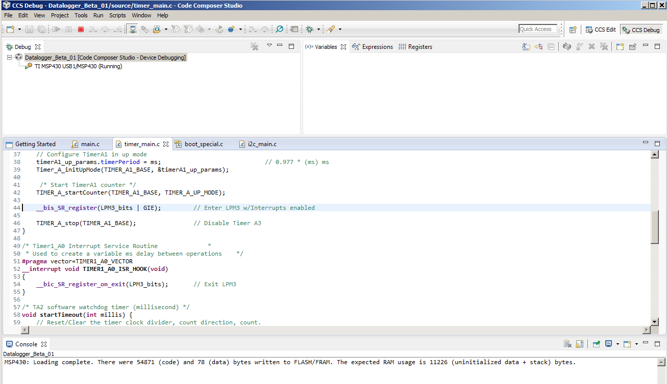

    Nathan, thanks for sharing the project privately. I was able to reproduce the behavior with CCS 6.1.0, MSP430F5527 target board and newer (black) MSP-FET. I did not see the issue with the older MSP-FET.
    To summarize, here are the steps that duplicate the issue:
    - First time I debug the project (by clicking the Debug button) all debug buttons are visible. I run, halt and terminate the program
    - Next time I debug the project, the Debug view shows focus on the debug configuration and says that the device is running (when it is really not) and does not halt at main. All debug buttons other than Terminate are grayed out (see screenshot1 below)
    - At this point, I can still click on the MSP430 device in the Debug view and click on Suspend, which puts the program at main (see screenshot2 below). And from here the debug buttons are activated again.
    Nathan, thanks for your patience and for confirming that this matches with the behavior you are seeing.
    I have filed bug # SDSCM00051805 to track this issue.
