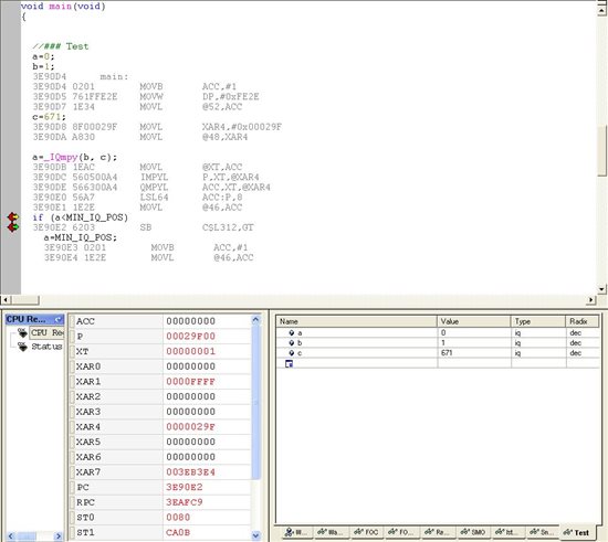

After a IQMultiply the result is compared if result is smaller than the smallest possible value (MIN_IQ_POS). If true the result should be set to MIN_IQ_POS. This operation fails. Altough the result after IQMultiply is 0 the compare thinks it is not.

The screenshot below shows all the registers.
The problem is that the flags "N" and "Z" are affected by the whole "ACC:P" Register and not only by "ACC". "ACC" actually holds the result (0) and "P" holds the residual value. If the optimizer is switched off the operation succeeds.
I'm quite shure this is a compiler bug. Is there any workaround? Are other operations affected?

    The assembler translation of the problem is as follows:
    _main:
     .dwcfi cfa_offset, -2
     .dwcfi save_reg_to_mem, 26, 0
     .dwcfi save_reg_to_reg, 78, 26
    ;* AL    assigned to $O$C1
     .dwpsn file "Test Firmware.c",line 268,column 3,is_stmt
            MOVB      ACC,#1
            MOVW      DP,#_b
            MOVL      @_b,ACC               ; |268|
     .dwpsn file "Test Firmware.c",line 269,column 3,is_stmt
            MOVL      XAR4,#671             ; |269|
            MOVL      @_c,XAR4              ; |269|
     .dwpsn file "Test Firmware.c",line 271,column 3,is_stmt
            MOVL      XT,ACC                ; |271|
            IMPYL     P,XT,XAR4             ; |271|
            QMPYL     ACC,XT,XAR4           ; |271|
            LSL64     ACC:P,#8              ; |271|
            MOVL      @_a,ACC               ; |271|
     .dwpsn file "Test Firmware.c",line 272,column 3,is_stmt
            B         $C$L1,GT              ; |272|
            ; branchcc occurs ; |272|

  • I can reproduce this bug.  I submitted record ID SDSCM00035932 in the SDOWP system.  Feel free to track it with the SDOWP link below in my sig.
