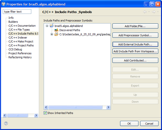

I have a "standard make" project that builds an IUNIVERSAL algorithm.  In my C code I have something like:
inArgs->base.size
Where inArgs is of type IALPHABLEND_inArgs.  Here's the definition of IALPHABLEND_inArgs from the included alphablend_brad.h:
typedef struct IALPHABLEND_InArgs {
    /* This must be the first field */
    IUNIVERSAL_InArgs base;
    /* ... add any extended fields here ... */
} IALPHABLEND_InArgs;
As you can see, it contains a structure of type IUNIVERSAL_InArgs which is defined by the included iuniversal.h (which resides in xdais):
typedef struct IUNIVERSAL_InArgs {
    XDAS_Int32 size;            /**< @sizeField */
} IUNIVERSAL_InArgs;
So my question is, how do I get the code completion to work such that it will pop us "size" when I type "base."?
Brad
  • Figured it out...
    1. Right-click on the project and select "Properties".
    2. Click on "C/C++ Include Paths & Symbols".
    3. Click "Add External Include Path".
    4. Click "Browse" and navigate to the appropriate source directory.  In my case it was the xdais/packages directory.
    Here's a screenshot:
