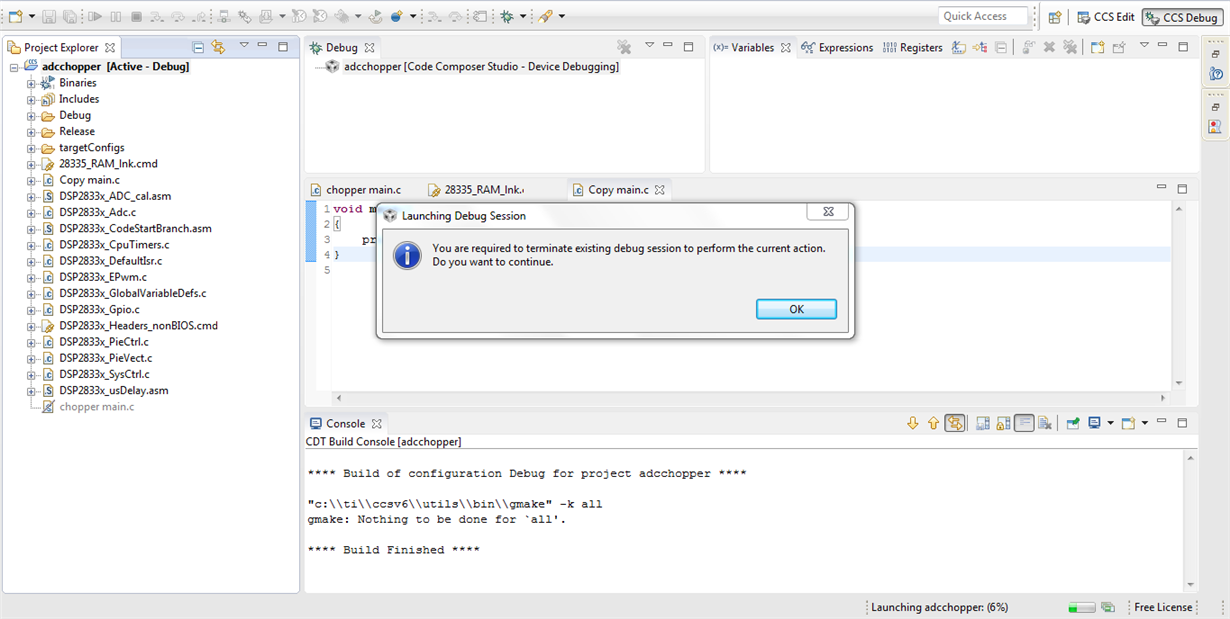

I am working on windows 7, 64 bit.
using CCS v6.0
Variant : 2833xDelfino , TMS320F28335
Connection: XDS100v1 USB Emulator
Compiler Version TI v6.2.5
One day before I updated my software and till yesterday it worked nicely.
But today morning, I started afresh to run a new program with new project.

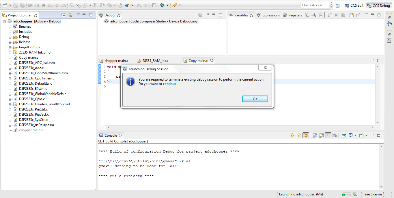

But when I try to debug the program, it gets debugged only 6% and then an error window popos up saying that
"You are required to terminate the existing debug session to perform the current action. Do you want to continue?"
Earlier, two options used to come in such case: yes or no
But, now it says only one option; ok and when I click on ok, nothing happens and debugging stops.
i have tried to run the program in new workspace, but the error remained same. Also, since the debug operation is not successful, so all other options to load program and to halt it are greyed.
Also, i can not find any button to terminate existing debugging session.
Attaching a snapshot of the above said problem.
Waiting for your reply!

  • Alberto Guzzi said:
    I have attached my zipped project with this reply.
    Thank you for attaching your project. I had to make some minor edits to the linker command file to get it the project to build. This may be due to a difference in the version of compiler that you and I are using, but after making the changes I was able to build and debug the project just fine. I ran the program, then tried starting a new debug session and the prompt came up as expected. I went through a couple of rounds of run, terminate, debug and everything worked as expected.
    Alberto Guzzi said:
    Today i went to my PC'c control panel and I saw that there are two CCS versions installed: CCS v.6.0 and CCS v.6.1
    I uninstalled CCS v.6.1 version with hope that my old version might work.
    I think this may have corrupted your CCS installation. If you did not have two completely separate installations of CCSv6 to begin with, then most likely the updates you picked up would have updated your CCS 6.0 version to CCS 6.1. In that case, uninstalling 6.1 from Control Panel would've surely messed things up. Moreover an uninstall of CCS via Control Panel is usually not very clean and complete. To get a clean uninstall we advise users to simply delete the entire directory where CCS was installed.
    I'm very sorry for the inconvenience, but in this case, it may be best for you to do a clean installation of CCS 6.1.0 in a different folder. Or if you wish to reinstall to the same folder as before, then be sure to completely wipe out your existing installation before starting the new install. You can download CCS 6.1 from http://processors.wiki.ti.com/index.php/Download_CCS
