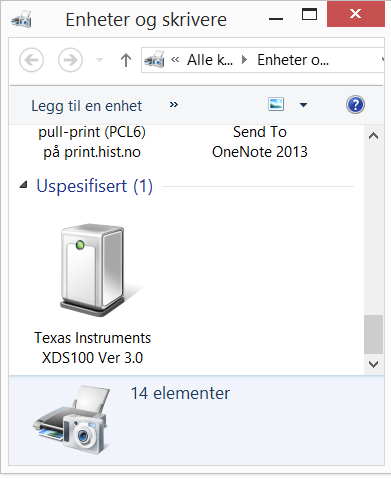

  • Both red and green leds are powered and the XDS100v3 is shown recognized at controll panel --> usb-devices.
    How exactly is your XDS100 being recognized by Control Panel? The reason is that another customer had trouble with his XDS100v3 from Olimex and the string shown in Control Panel was radically different than the one I saw with mine...

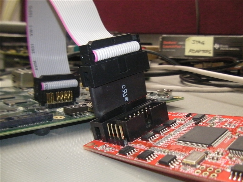

    Also, if you are using the same Olimex XDS100v3, can you double-check where that small board adapter is placed? In my case the board adapter is closer to the JTAG debug probe. If I flip the cable and leave the adapter end connected to the target board instead, I get connection errors.

  • When I plug in the usb from the xds100, I can see from"Devices and printers" that it shows the XDS100v3 (I'm from Norway, so it's written in norwegian):
    Here is how I'm connecting it:

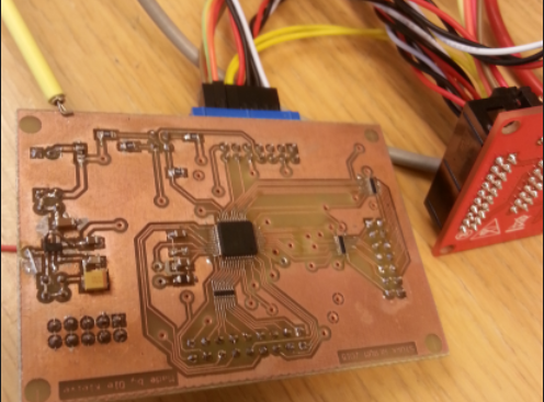

    I used to connect to the 14-pin jtag on the right side of the picture above, but now when I switched it finally connected! But now a new error has shown...The xds is connected to a PCB I've designed:

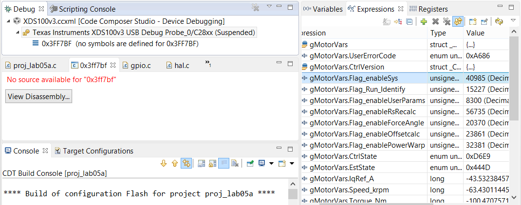

    As I right-click on "Texas Instruments XDS100 XDS100v3 USB Debug Probe_0/C28xx" and hit "connect target" it says "suspended", which I think is the right behavior? A new message says "No Source available for "0x3ff7bf" and my variable doesn't have any values:
      As you can see on the picture, I'm currently running proj_lab05a.c. Sorry for all the pictures as it can be confusing, but it would be nice of you if you helped me with this problem too. Thanks!
    Thanks for sending the details; you surely got past the basic connection error, as CCS is able to properly communicate with the device.
    Yes, it is. You are connecting to the core manually, as described on section 4.2 of the page below:
    processors.wiki.ti.com/.../Debug_Handbook_for_CCS
    For reference check this post.
    It is because at this point your processor has no code and symbols loaded. The same section above explains how to load code to the core, thus allowing you to see the global variables in the expressions view.

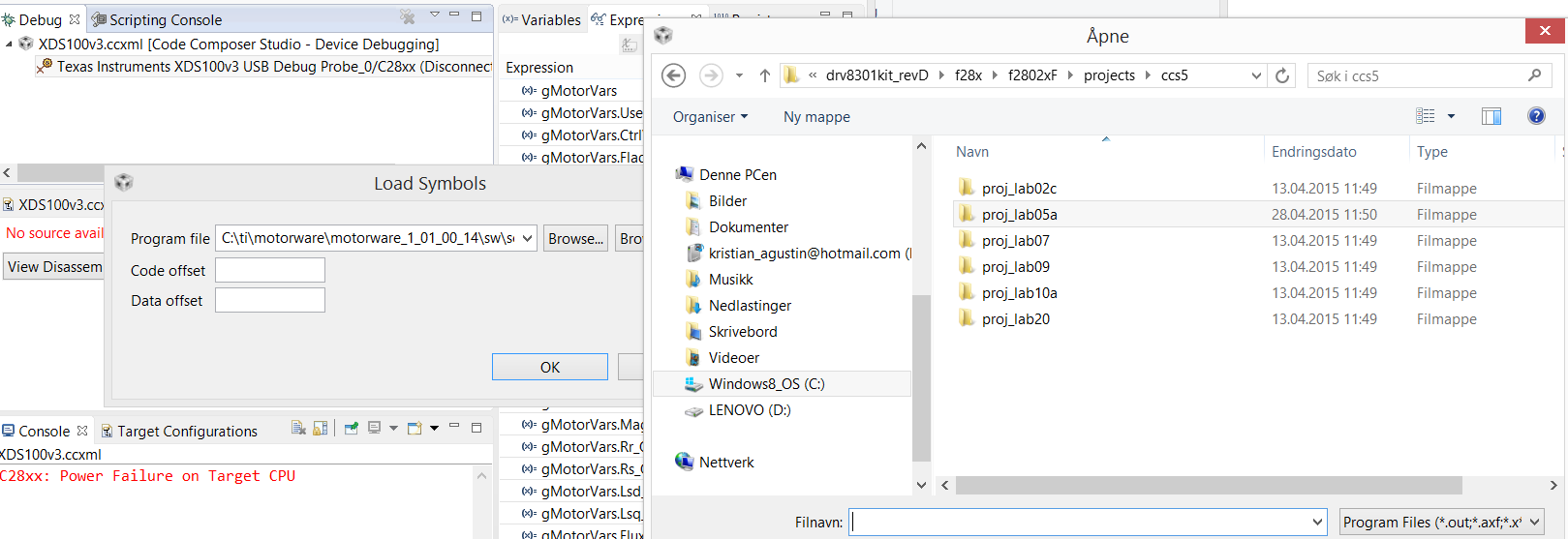

  • "After the debugger launches, connection can be established by right-clicking on the core and selecting Connect. Once the core finishes executing its initialization GEL script (if one is required), the code or symbols can be loaded by going to menu Run --> Load --> Load Program or Load symbols".
    This might be a dumb question, but which file am I looking for when I hit "Run" --> "Load" --> "Load Symbol"? Something about BOOT ROM, but I can't find this file... Thanks in advance!
    If you already have code loaded and running on your device, the .out file created when you build your project will have the debug symbols - no special file is needed. Obviously that your project must have been built with debug symbols (the -g option) - that is likely the case, as it is the default configuration of any project.
