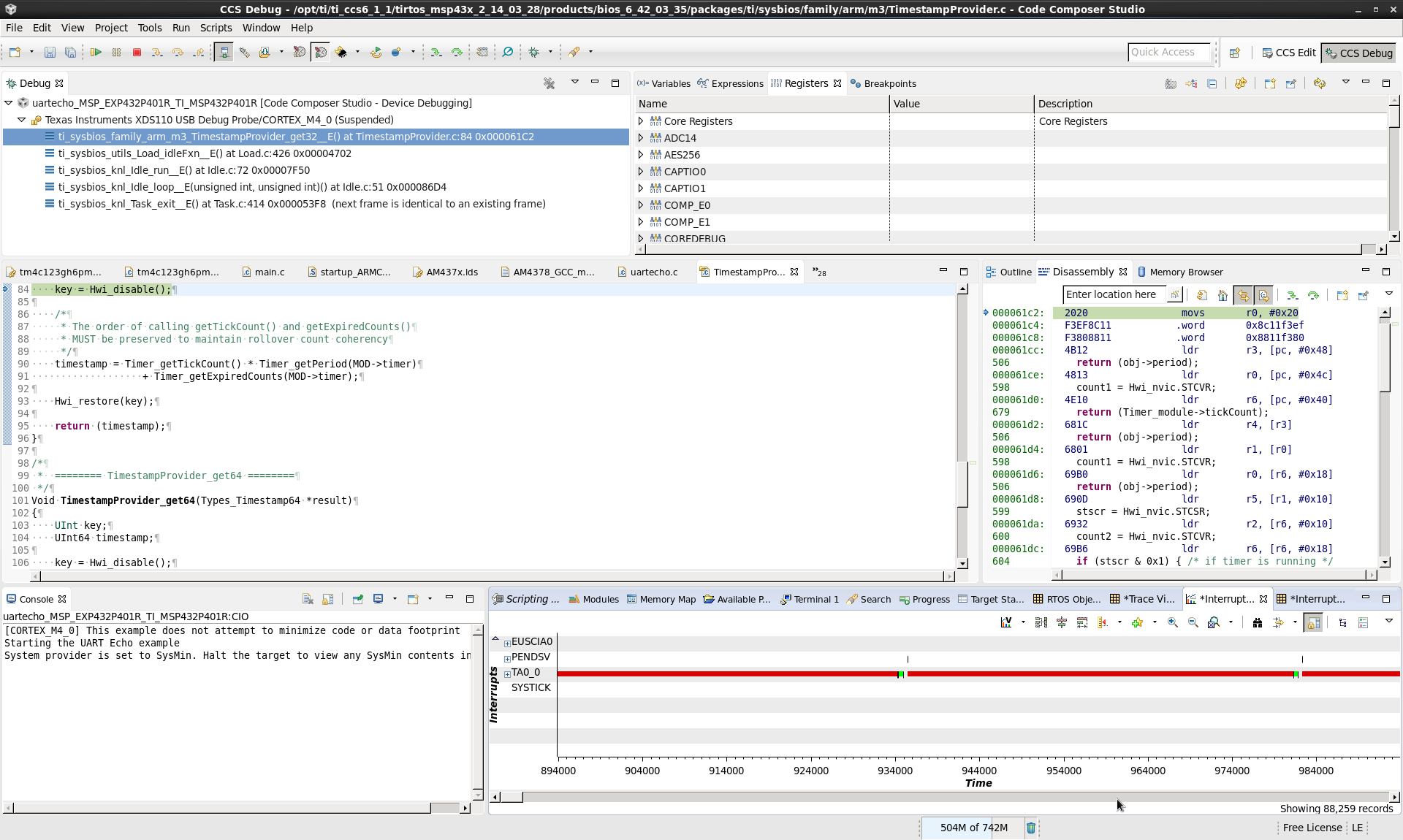

    Attached is a "hang" log generated from CCS 6.1.2.00014 running under CentOS 6.7 64-bit. hang_23_55a871fc-d241-d9e8-160fc907-26193307.dmp.zip
    CCS 6.1.2 hung when scrolling through the Interrupt Analyzer Graph, taken from a MSP-EXP432P401R using the onboard XDS110 with SWO trace transport. At first I believed this was a repeatable test case to create a hang, since after killing and then re-starting CCS 6.1.2 a hang could be generated by taking another Interrupt Analyzer trace and scrolling though the Interrupt Analyzer Graph. The following screen shot was taken at the point the CCS 6.1.2 GUI hung, with the last action taken to click on the scroll bar on the Interrupt Analyzer Graph:
    The screen shot shows the number of editor tabs and debug views open when I had the repeated hang (got the hang in 5 restarts of CCS 6.1.2 using the same workspace and leaving the displayed editor tabs and debug views open).
    After closing all the editor tabs and debug views, and starting another debug session and only explicitly opening the Interrupt Analyzer view so far I have been unable to repeat the hang, in that can take an Interrupt Analyzer trace under the same target conditions as before and have scrolled the Interrupt Analyzer Graph without CCS hanging.
    Therefore, maybe the hang is caused by some combination of views / editor tabs being on display at once.
