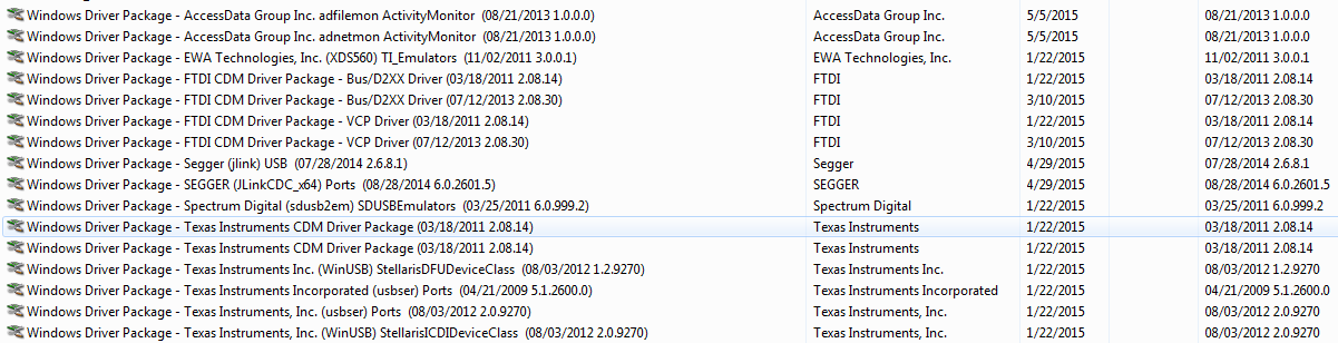

Customer cannot get the USB drivers working with CCS v6.1 for TMS320F28069 dev kit.  The drivers show up in Device Manager under USB Drivers, but the COM port does not show up under Ports (COM and LPT).  We've tried uninstalling and reinstalling the device drivers and CCS.  Customer is running Win 7 64-bit with administrative rights.  The OS and drivers are the same as my PC.  We've also tried uninstalling CDM Uninstaller 1.4 - Windows Device Driver Uninstaller: http://www.ftdichip.com/Support/Utilities.htm
I've run out of ideas to try.  Any suggestions would be appreciated.

    Can they attach a screenshot of their Device Manager for us to look at?
  • Included below is the customer driver screenshot.  Let me know if you have suggestions.
    Mark
  • Mark,
    Nothing really stands out from this screenshot. What I was actually asking for though was the Device Manager screenshot that shows the COM ports and XDS100 channels.
