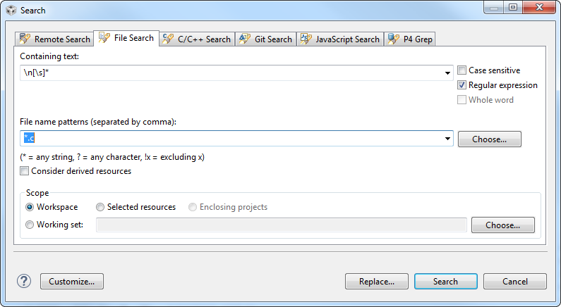

  • Mike,
    I have been searching around for an Eclipse plug-in that does it but no luck so far.  If you are on Linux there are some commands that you can use but I believe you are on Windows.
    One command to try on windows CCS is to go to File Search.
    Enter \n[\s]* as the search string and check the regular expression box.
    Then enter *.c as the File name pattern

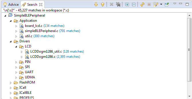

    Then in the search window it gives me the count.
