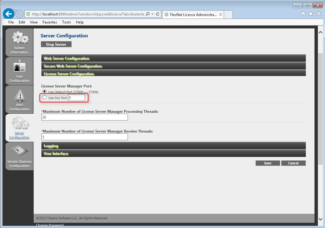

Code Composer 6 on a VMWare floating license Server (Server 2008) and port changed
Currently the licensing server resides on a Server 2008 which is a virtual on a WMware ESXi host.  The licensing server was serving clients flawlessly for a couple of months.  At 3:00 AM this morning this changed.  Clients were unable to acquire a license.  After much troubleshooting/research I found the Vendor Daemon Port changed.  Once we modified the clients, we were then able to obtain a license.  What would cause this to change and how would I prevent it from occurring again.  Nothing on this server has changed, nor has it received updates.
Thank you in advance for your time.
