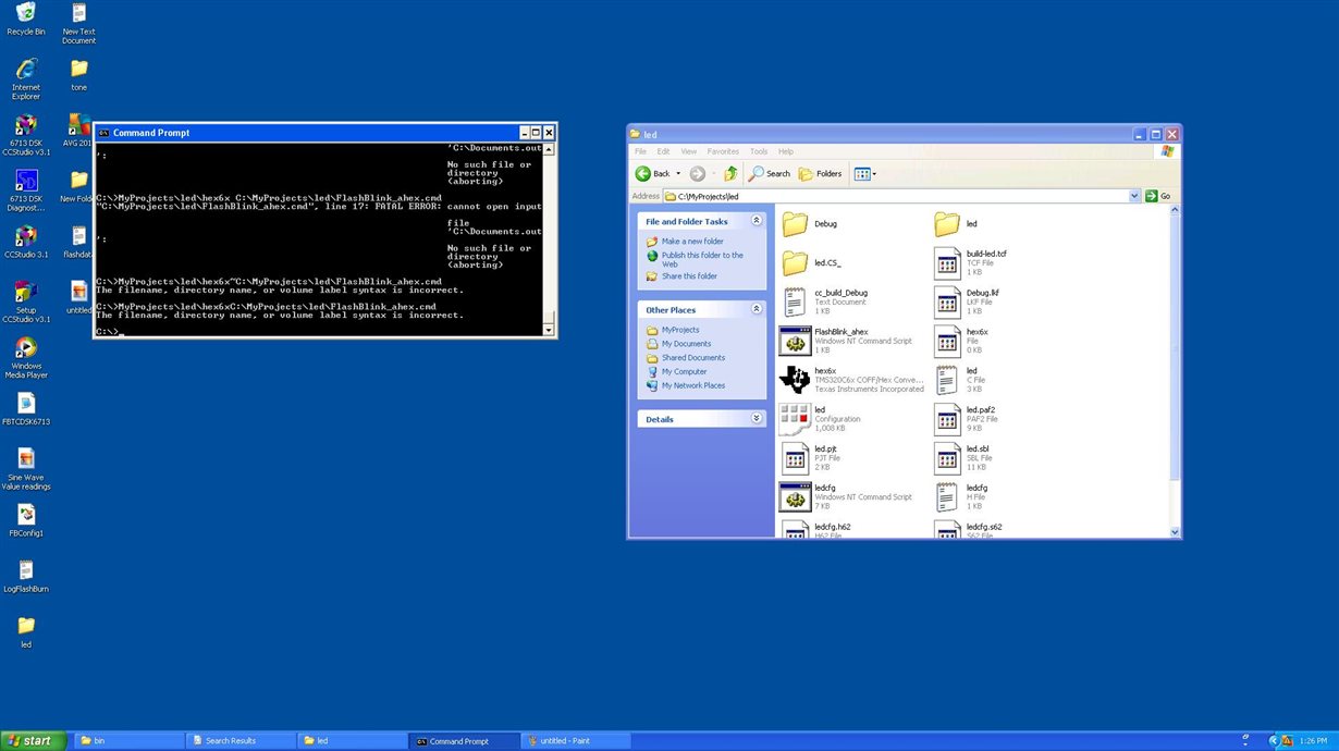

  • Yes command file exits in that directory. I also tried moving the hex.cmd file to no space directory, still i see the same error.
    Have attached the screen shot
  • The command line:
    C:\MyProjects\led\hex6x C:\MyProjects\led\FlashBlink_ahex.cmd
    is throwing an error at line 17 of the .cmd file saying: "cannot open input file ..."
    That line most likely specifies the path to the .out file. Please check that the .out file exists in that path and is named correctly, and that the path to the .out file does not contain spaces.

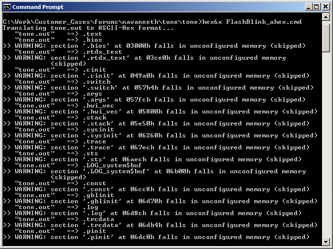

  • I cannot reproduce your error. Please see my screenshot below. There are warnings during the hex conversion however the command itself is invoked fine.
    The warnings occur when the executable contains sections whose load addresses fall outside the memory range defined by the ROMS directive. In this case you can check the linker map file to confirm where all the sections are being placed and make sure those address ranges are defined within the ROMS directive. Please refer to the Hex conversion chapter in the Assembly Language Tools Users Guide.

  • This is the hex conversion map file. I was referring to the link map file.

  • Navaneeth Karthikeyan said:
    This is the linker map file
    This is not the linker map file, it is the linker command file. Also since this is a BIOS project, there is an additional linker command file auto-generated by BIOS that defines certain memory regions and allocates BIOS sections to those regions.
    The sections listed in the hex conversion process as falling in unconfigured memory are mostly BIOS sections. If you generate a link map file as part of your project build (not the hex conversion process), then you can see where all these BIOS sections are getting allocated. Once you have that information you can add those memory regions to the ROMS directive in your hex conversion command file.
