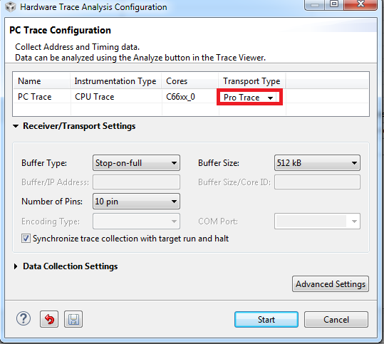

We created a javescript to simulator "PC trace" on our tracepod , but didn't get the right result now. Anyone can help me ? thanks !
CCS version is 5.5.0,OS is window XP.
What we do in manually trigger was : Tools->Hardware Trace Analyzer-> PC Trace(set startaddress,buffer size in this view) , make code go into function of “startaddress” , then we can see the data in "trace viewer" and the exported csv was start from this address.
But we didn't get the same behavior when using scripts , the “trace viewer”was not waiting for buffer full and the exported csv was not started with right address .

var data = {"configurationFile":"Nyquist.ccxml","logFile":"script_log.xml","portNumber":5000,"cpuName":"Spectrum Digital XDS560V2 STM USB Emulator_0/C66xx_2","outFile":"cpu3.out","receiverName":"Pro Trace","channelSetupFile":"TraceCntrl_DefaultSettings_ETB.xml","tracepodReadyFile":"trace.csv"};

analysisSession = dvtServer.openAnalysisSession();
analysis = analysisSession.loadAnalysis("PC Trace");
script.traceWrite("########### Begin to set analysis!!!");
analysisSession.setAnalysisProperty(analysis, "transportType", "Pro Trace");
analysisSession.setAnalysisProperty(analysis, "startAddress", "0x0c12b300");
analysisSession.setAnalysisProperty(analysis, "bufferSize", "1 MB");
analysisSession.setAnalysisProperty(analysis, "numberOfPins", "10 pin");
analysisSession.setAnalysisProperty(analysis, "bufferType", "Stop-on-full");
analysisSession.setAnalysisProperty(analysis, "synchronizeWithTarget", true);
script.traceWrite("########### Begin to run analysis!!!");
//analysisSession.runAnalysis(analysis);
analysisSession.run();
