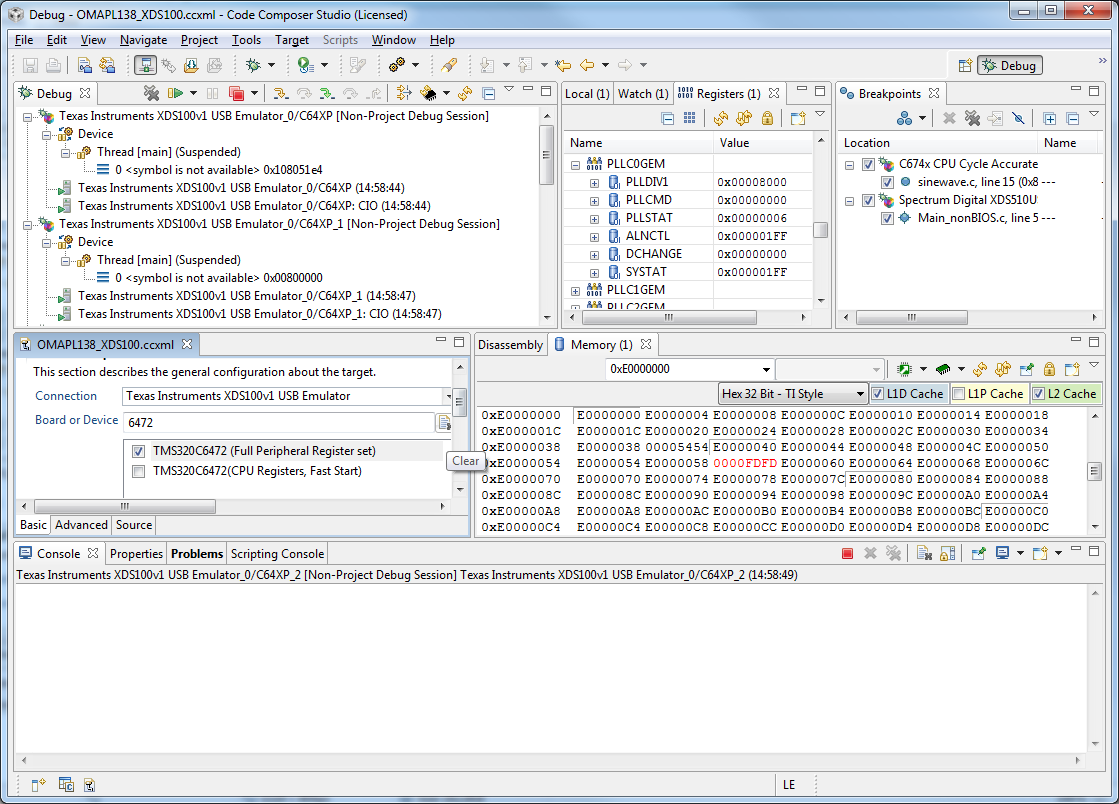

  • Dominic,
    I installed the software from the CD that comes with the EVM and managed to connect to the C6472 board using the embedded emulator (XDS100) without problems.
    - Installed the file <EVMC6472_SDK_Setup_v_0_1_beta.exe>
    - Opened CCSv4 and created a new target configuration, configuring it as listed at this page.
    - Connected to the target and managed to have access to all memory regions and peripherals (check the attached screen).
    I am using CCS 4.1.1.00014 on a Win7 64-bit PC and the board is a EVMC6472-Beta15.
    One thing that I did not realize and got an error right from the start was the power supply requirements - the board requires 12V but I initially connected it to a 5V power supply as it is very common across other boards. This caused me errors similar to what you are experiencing.
    Another detail is to be sure the XDS100 device driver initializes properly when the board is connected to the PC - although this didn't happen with me this time, it happened a while ago with another board and it took me a while until I had to manually install the driver.
    Hope this helps,
    Rafael
