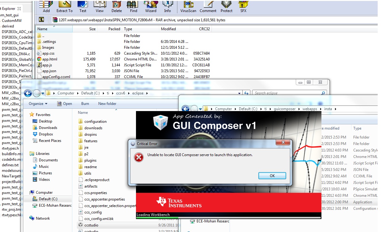

I am getting this error report when i try launching the app file from ccsv6.1 to GUI composer. Kindly look into the issue and let me know if there is anything wrong with the installation. Thank you.
SaiPriya,
In CCS 6.1, GUI Composer can be installed as an add-on via the CCS App Center (menu Help->CCS App Center).
