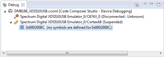

    I was able to connect to the A8 of my DM8168EVM using CCSv6.1.0 and a Spectrum Digital XDS510USB PLUS:
    Note that the first time I tried to connect with the XDS510USB, CCS got hung and I don't know why. I just closed CCS, power-cycled the target and tried again and it worked after that. You can also try using a different USB port since your error indicates a USB connection (PC <-> Emulator) failure. If you are using a USB hub, try using a USB port not on a hub.
