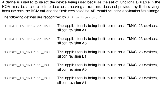

  • Chinmay Admane said:
    All these functions/symbols (ROM_GPIOPinConfigure..) are present in the rom.h files.
    What could be the problem?
    The driverlib/rom.h include file requires a TARGET_IS_* preprocessor symbol being defined to select which device is in use. There is no actual functions such as ROM_GPIOPinConfigure in a library - the names such ROM_GPIOPinConfigure are macros which result in calling functions stored in the device ROM via look-up tables of function pointers at known addresses.
    See section 35.2 Direct ROM Calls of the TivaWareTM Peripheral Driver Library USER’S GUIDE for details:
  • Thank you for your answer..!! It worked..!
    All I had to do is include : #define TARGET_IS_TM4C129_RA1
    Also I would like to tell that a function used in pinout.c (ROM_GPIOPadConfigSet) is not present in the rom.h  for TM4C129_RA1 so it still shows the unresolved error. So I tried to look and find out how they have handled it in the example enet_lwip and they have replaced that function with MAP_GPIOPadConfigSet. This replacement of "ROM" with "MAP" also works for other functions without defining the target TM4C129_RA1.
    Thank you.
    The "MAP" macros either end up calling a function in flash (from the TivaWare library) OR a function in ROM.
    E.g. if there is a call to MAP_GPIOPadConfigSet in your code:
    - If rom.h has been included AND a TARGET_IS_* macro defined AND a ROM_GPIOPadConfigSet function is available for the given target then the ROM_GPIOPadConfigSet function is called
    - Otherwise the GPIOPadConfigSet function is called from the TivaWare library, which will be placed in flash by the linker
    Therefore, if you don't define the target TM4C129_RA1 all "MAP" functions will end up as calls to TivaWare library functions in flash.
