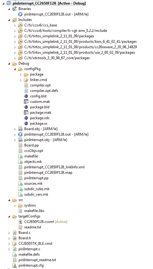

This is what the BLE stack sample looks like in CCS. Can someone please post an equivalent/similar screenshot of the TIMAC sample in the IAR?

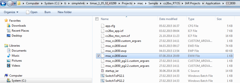

The sample can be found in the following folder after downloading TIMAC 1.5.2.xxxxx:

    Extract ("Extract Here") msa_cc2650.zip to: .\timac_1_05_02_43299\Projects\mac\Sample\cc26xx_RTOS\CCS_Project
    Extract ("Extract Here") cc2650stack.zip to: .\timac_1_05_02_43299\Projects\mac\Stack\cc26xx_RTOS\Stack\CC2650

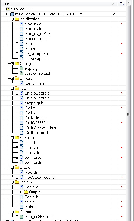

  • Thank you Ki-Soo Lee. Can you also please post the screen shots from the IAR EW environment please? The screen shots from the project explorer (like in CCS) and the screen shot of any settings windows, for example similar to the start window for the project setting in CCS? Thank you so much Ki-Soo Lee.
  • Thank you Chester Gillon. However, I cannot download the IAR due to administrative issues.

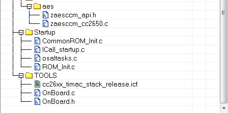

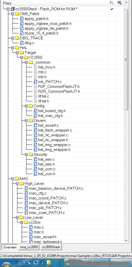

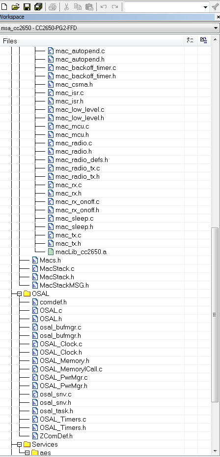

  • Attached is screenshots of IAR EW's equivalent of the Project Explorer:
    msa_cc2650 (note that unexpanded nodes under the source file just expand to generated object files from the compiler)
    cc2650stack (3 parts):
