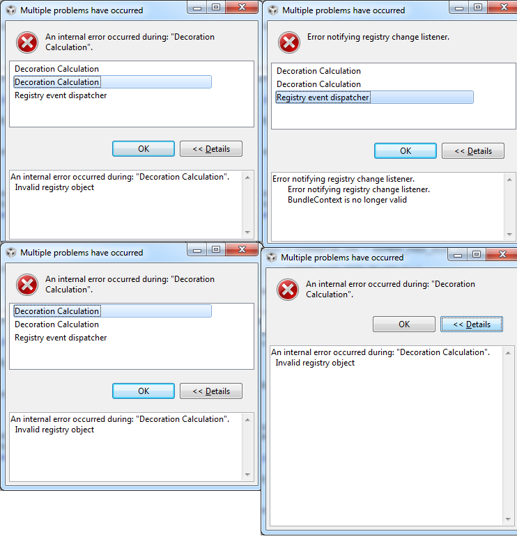

Hello Danish,
I tried to install "TI Target Content" again and this time "TI Target Content" version number changed. Another app installed at the same time as "TI Target Content", however, I can't remember the name of the app. After the installation I received the error dialog boxes shown below. Also, I wasn't able to close CCS, so I started the task manager and selected "end process tree" for CCS.
After restarting CCS, the errors shown below occurred after performing another search for updates. What would be the reason for 'Gateway Timeout'?
Stephen

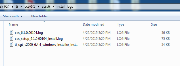

I didn't see an install log for the June 23 or 24th. After the installation (today), CCS stop responding to mouse and keyboard inputs, so I had to close the program using the task manager. That may be the reason it never saved an install log. Should it have saved an install log for the TIRTOSc2000 and xdctools installation that was installed yesterday?
Stephen
