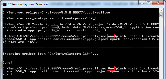

I am trying to build my project from command line (cmd box under windows 7).
It seems to work but the -noSplash option is of no use (I still see the splash screen wether or nor I add this option).

  • the command line is:
    %eclipse%\eclipsec –noSplash -data ccs_workspace -application com.ti.ccstudio.apps.projectBuild -ccs.workspace

  • the command line I typed is:
    > ccs-build.cmd
    (with no parameter)
    and the script is:
    @echo off
        set eclipse=D:\TI\ccsv5\eclipse
        for /f "usebackq" %%F in (`dir /b /s *.project`) do (
            %eclipse%\eclipsec –noSplash -data ccs_workspace -application com.ti.ccstudio.apps.projectImport -ccs.location %%~dpF
    for each eclipsec passed, a splash screen is seen.

  • Thank you for the cut and paste of your script. When I cut and paste your script to my environment, I can reproduce the issue. When I turn echo on, I can see why. It is not a proper dash infront of noSplash. When I modify the script and replace the character with a proper dash, the issue goes away:
    Give that a try and see if that works for you.

  • Thank you Ki.
    After dash replacement, it works also for me.
    The issue was due to a copy/paste from processors.wiki.ti.com/.../Create.
