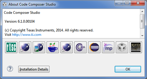

I'm using ccs version 6.1.0.00104 on Windows 7:

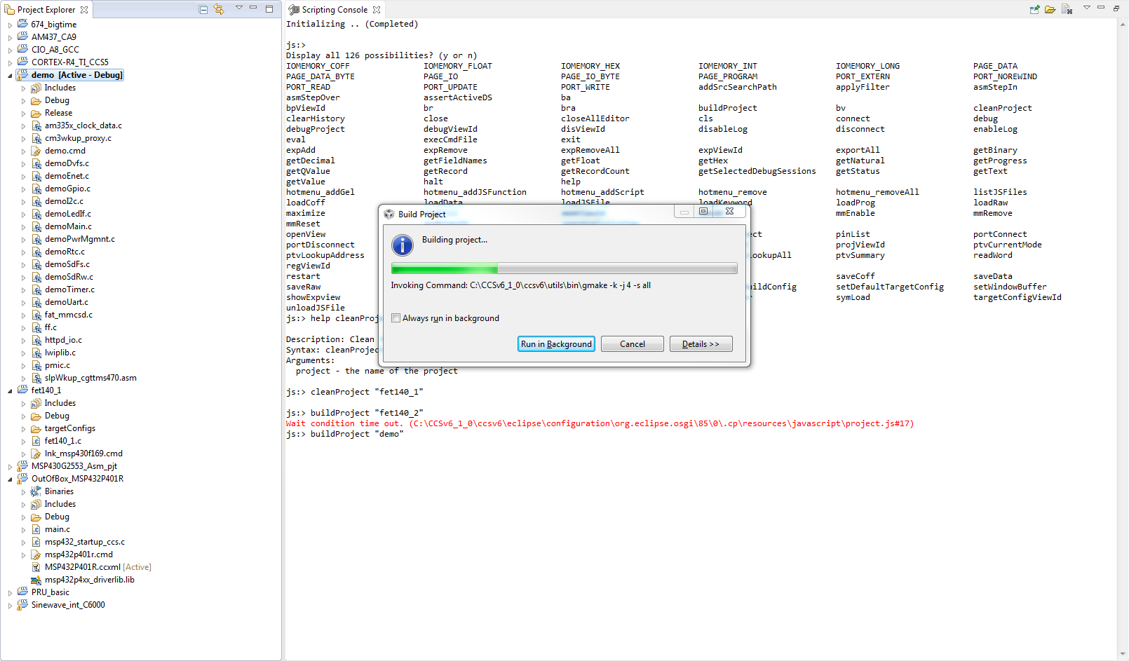

    Interesting. I get the same issue when I type the name of a non-existing project in my workspace, and I tried with both copied or linked projects of my workspace
    In the picture below (click to expand), the "demo" project is linked, while the "fet140_1" (used by cleanProject) is copied.
    Therefore, I am unsure what may be happening. A long shot would be, perhaps, if the projects are located in remote drives or are version controlled (some folks have experienced some strange issues under these scenarios).
