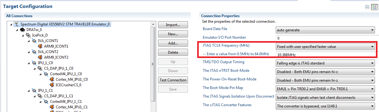

  • Vijaya,
    The most common cause of the issue you reported is an incorrect JTAG TCLK setting. Make sure it is set to "Fixed with user specified faster value" and set it to "10.368MHz":
    ki

    Thanks for your fast  response.
    After changing freq to 10.38MHz, I am not getting the JTAG clock error.But instead, I am getting below error:
