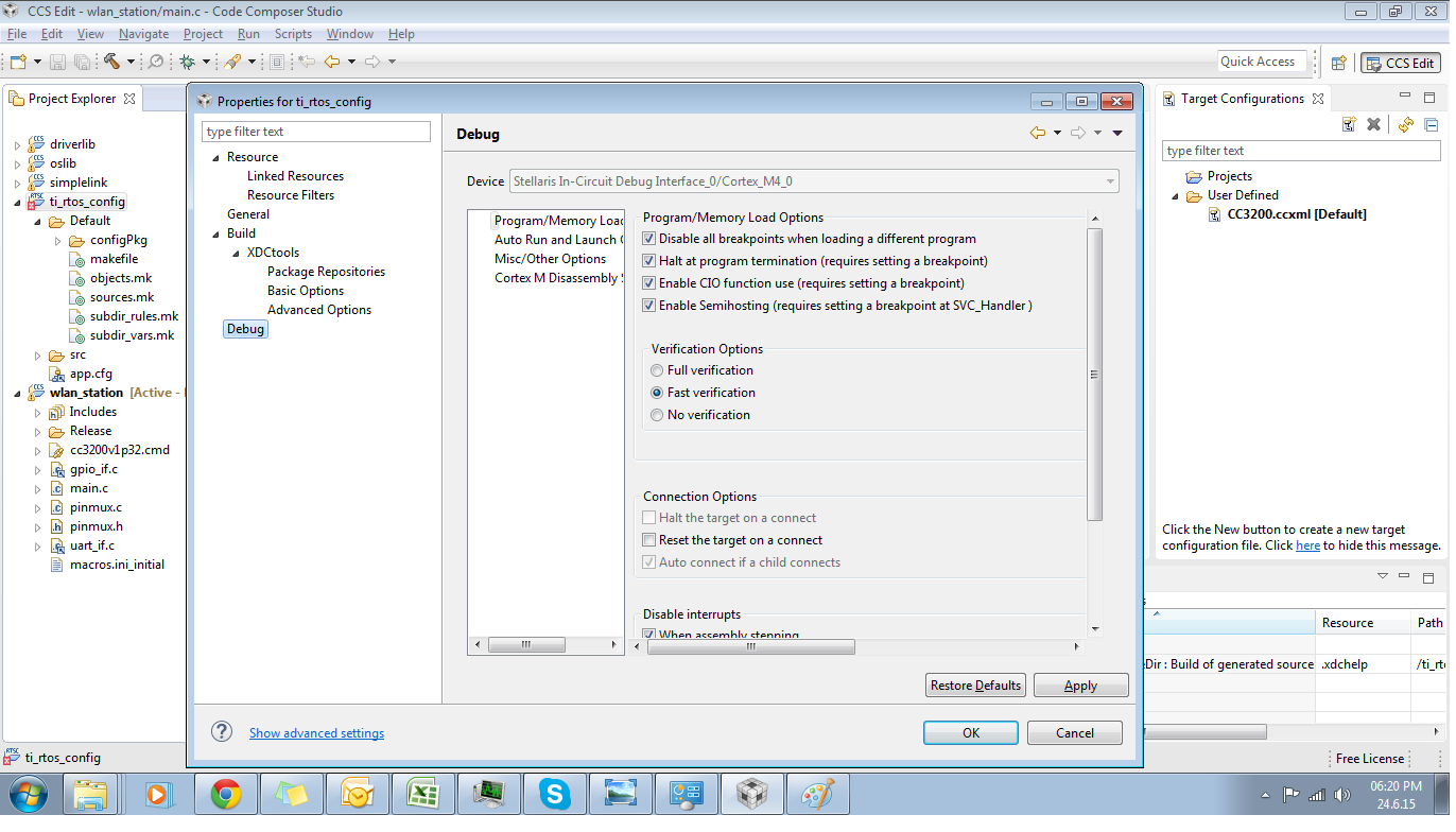

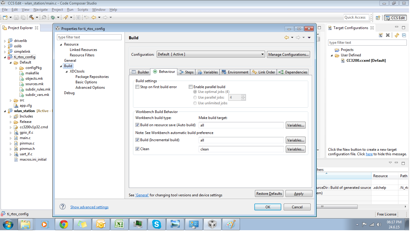

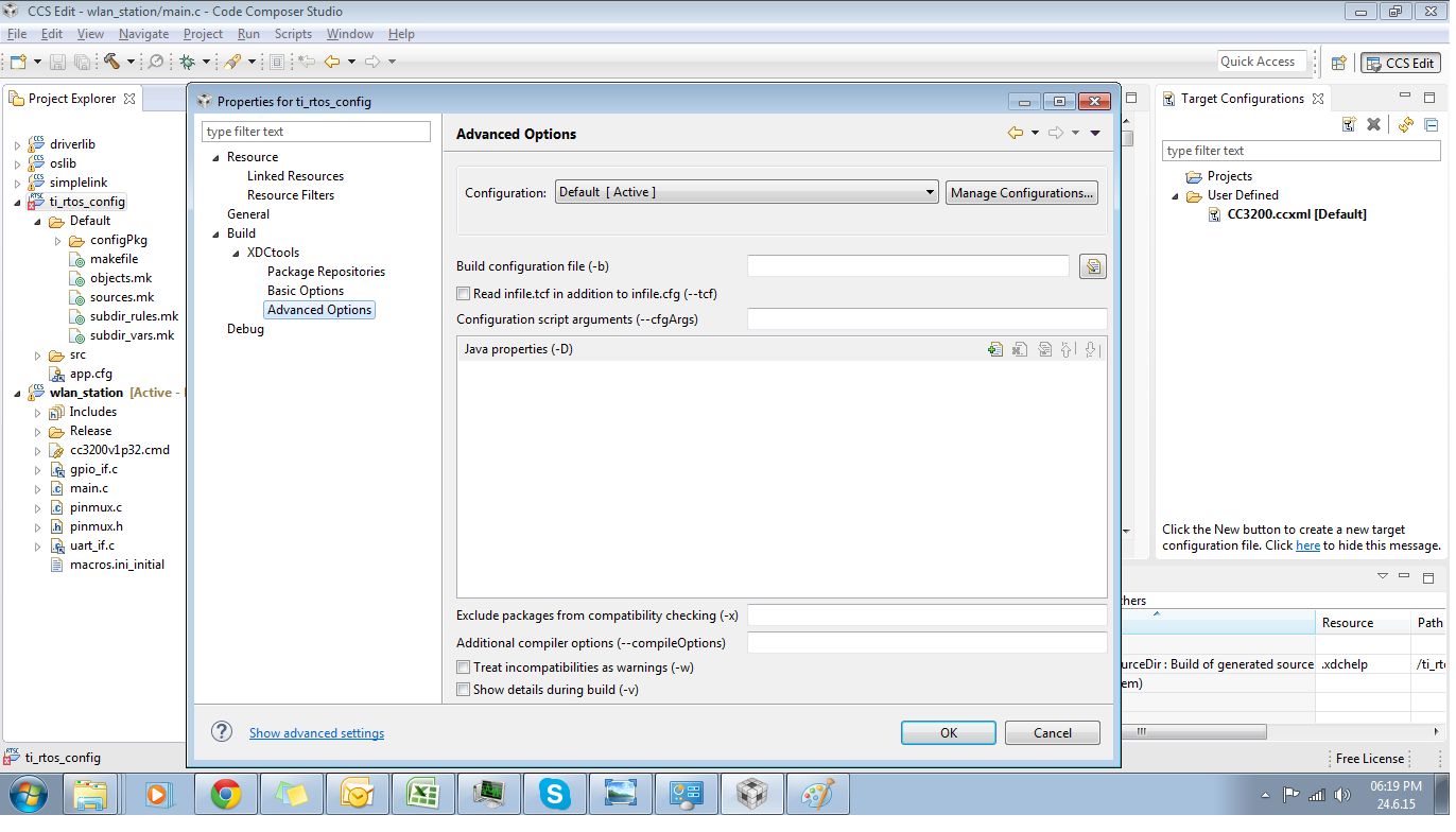

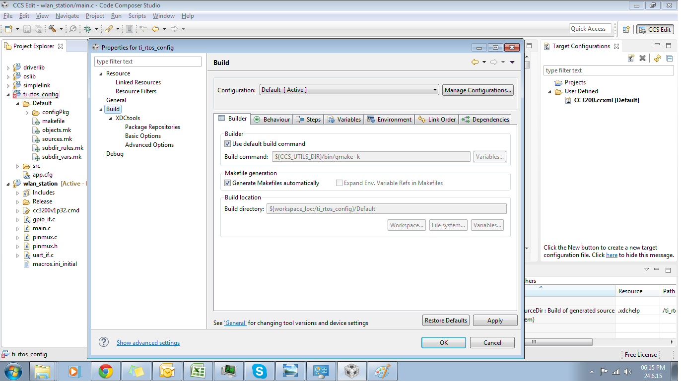

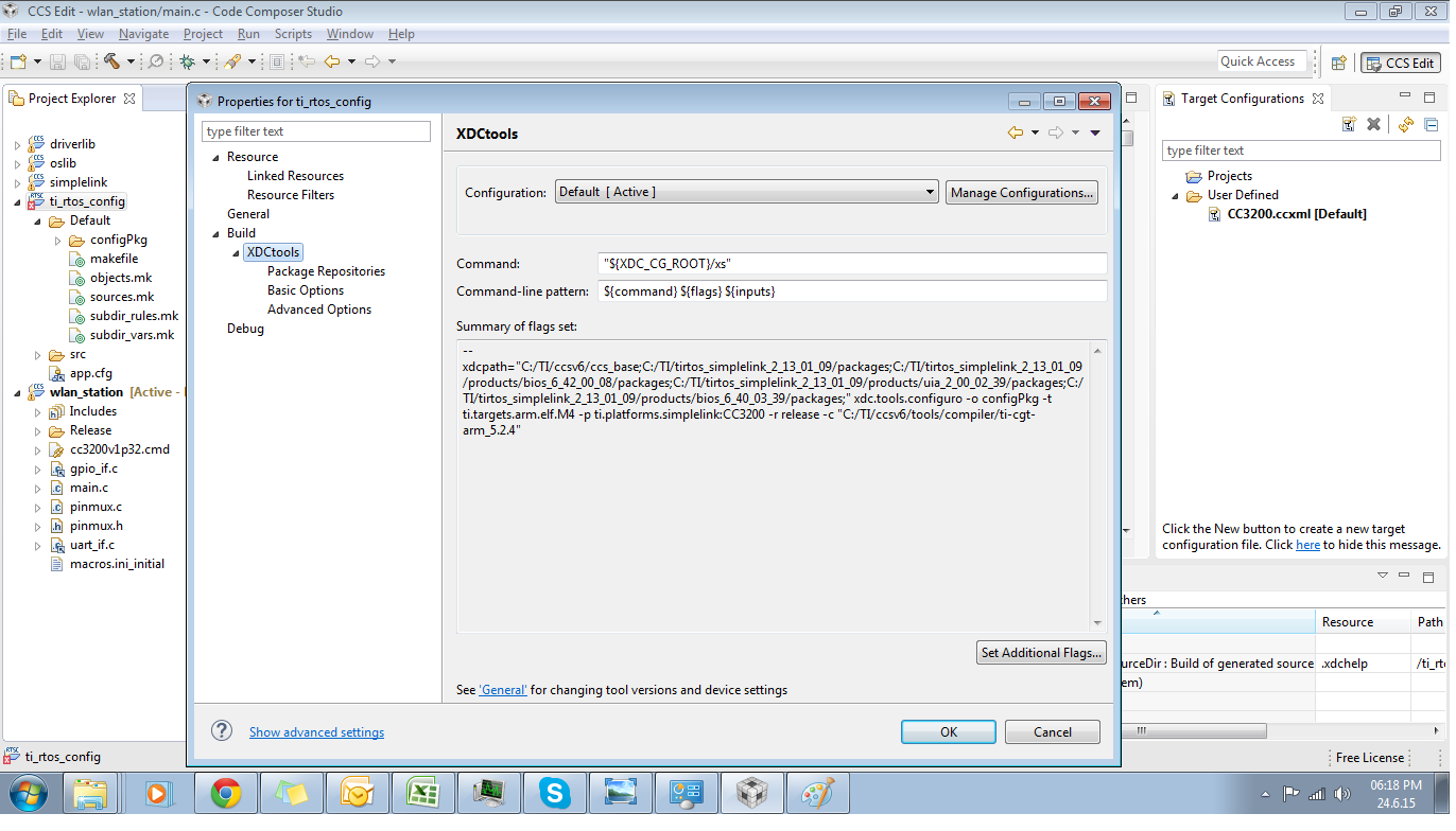

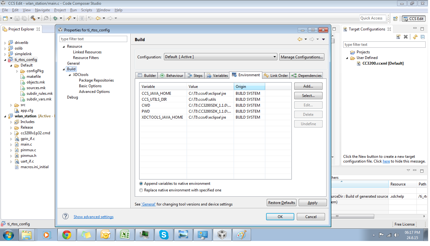

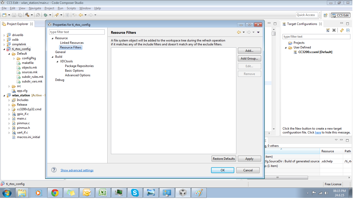

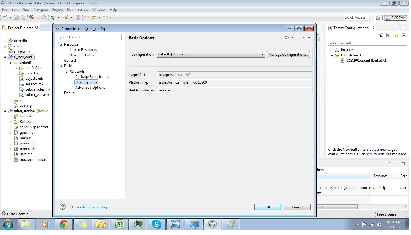

Please find the snap shots for the properties for the ti_rtos_config

  • Amir,
    Interesting. Somebody just reported a similar issue. Can you check the threads and recommendations at the thread below?
    e2e.ti.com/.../1551678
    Rafael
    My CCS6.0 was installed in C drive whereas my workspace was in D drive and there was no issue in CCS6.0
    But now also my CCS6.1 is installed in C drive and my workspace is in D drive.
    I have changed the workspace and created more than 5 workspaces also but same issue persists.
    As for the project it is the wlan station project in the CCS sdk   examples, which also i am not able to work it out.
  • Amir,
    Thanks for sending the additional details. When I compared the screenshots you mentioned with the SDK getting started guide, I found that all support components (TI-RTOS, XDC Tools, compiler) have different versions.
    I don't expect the compiler to change things radically, therefore I used the default 5.2.4, but when I downloaded and installed the exact same releases for the TI-RTOS and XDC Tools, the projects built fine.
    Therefore, it is a problem with the SDK itself and the incompatibility with the updated component releases that were shipped with CCSv6.1.
    In this case there are two options:
    - Install the previous releases and keep the project that way;
    - Ask the experts on the LPRF Tools forum for an updated SDK that uses newer tools;
    - Ask the experts at the TI-RTOS forum to help with the migration to the newer components.
    Unfortunately we at the CCS forum will not be able to address this adequately.
    I apologize for the trouble,
    Rafael
