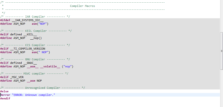

Everything in my project works except for the following:
hal_types.h
I would get the following error:
I tried to fix the problem by doing the following, but this did nothing except for allow me to build the project successfully without any errors.
Then, if I tried to debug the built project with this temporary fix, I would get the following error message:
Any ideas on how to fix this?
Thanks in advance!
    Are you working with SimpleLink examples? If so, you need to specify the compiler version being used via the -D / --define option. and it sounds like that is missing in your case. Try adding the following predifine in your build options.
    __TI_COMPILER_VERSION=1

    I am using SimpleLink. I forgot to mention I am using the CC2650STK with the DevPack JTAG Debugger.
    I tried your suggestion and the the project built without me having to try my "bandaid solution". However, after trying to start debugging, the CCS gives the same error again. I also tried changing this value to another value that I found in the build options: 5002002. This seems to be going down the right path to a possible solution since it the project did indeed build. Do you think there is something else that might be able to fix the issue?

  • Are you using one of the default examples or are you creating a new project? That option should be part of the examples so I'm wondering why it is missing.
