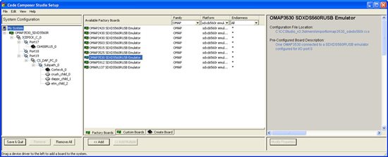

    i recently upgraded the emulator drivers from Spectrum Digital website, which populated some more recent configurations for the OMAP35x into the CCS v3.3 install directory.
    when running Setup CCS v3.3 i've selected the OMAP3530 SDXDS560RUSB Emulator from the list of available Factory Boards as shown below

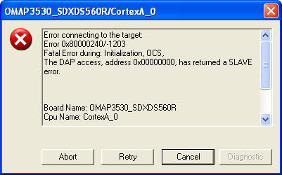

    this runs ok most of the time but occasionally when restarting this same sequence we get the following error displayed, which requires an emulator and target reboot to fix? or at least that's the only thing i can figure out to resolve it.
    Warning: Error 0x40002240/-1045 Warning during: Initialization, OCS, Control,  Device driver: Cannot release emulator process.

    I really don't see a problem in the sequence of events on your script; the procedure is very similar to what I usually do with the SoC devices and yes, sporadically I get the error you reported and I usually disconnect the target and try to reset the emulator before doing a "cold boot" on everything. I don't have a 560R emulator but I use either the XDS100v2, the BH560m or the XDS560PCI.
    I will try to investigate a bit more but overall I don't see any leftovers at the end of your script.
