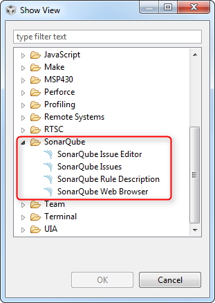

SonarQube website mention support for Eclipse via a plugin. Since Code Composer 5 is Eclipse based I was able to install it but I cannot finish the configuration by linking the project as described. When I right click on the project in the Project Explorer there is no option to Configure then Associate with SonarQube.

    We don't have any experience with SonarQube.  I did go ahead and install the plug-in into both my CCSv5.5 and CCSv6.1 installations.
    After installing I do see a series of SonarQube views.  I see them if I go to Window -> Show View -> Other
    I also see preferences for setting up the server

  • I think it is perspective related. In CCS we use the CCS Edit perspective for editing. In stock Eclipse there is the C/C++ Perspective. If I switch to the C/C++ perspective in CCS then I see the menu item.
