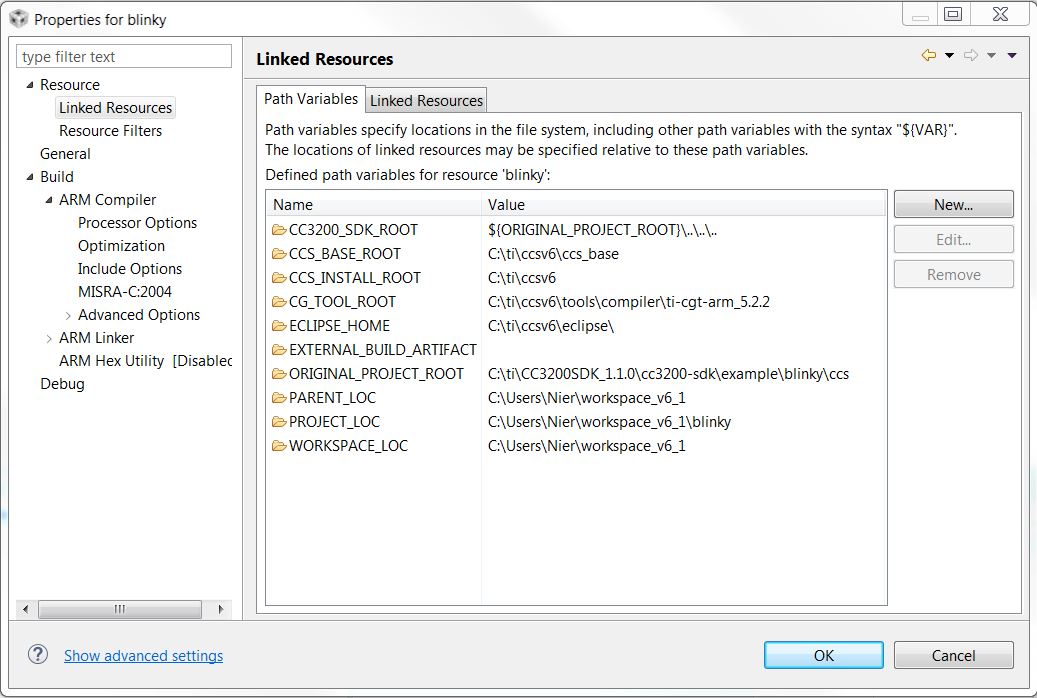

  • According to log in above post the CCS is looking for ARM compiler at ""C:/ti/ccsv6/tools/compiler/ti-cgt-arm_5.2.2/bin/armcl"" but the correct path should be "C:/ti/ccsv6/tools/compiler/ti-cgt-arm_5.2.2/bin/armcl"
    Can you please share the image of your project properties showing the list of linked resources?
    Project properties->Resources->Linked Resources
    Ankur
  • Do you have other version of compiler?
    If yes, can you please try the later version. You can change the compiler from the 'General' section in project properties.
    Ankur
    i installed the ti-cgt-arm_5.2.4 from the app center, and selected it from the general properties, but the same error occurs. Of course the log now is related to this compiler:
    **** Build of configuration Release for project blinky ****
    "C:\\ti\\ccsv6\\utils\\bin\\gmake" -k all
    'Building file: C:/ti/CC3200SDK_1.1.0/cc3200-sdk/example/common/gpio_if.c'
    'Invoking: ARM Compiler'
    "C:/ti/ccsv6/tools/compiler/ti-cgt-arm_5.2.4/bin/armcl" -mv7M4 --code_state=16 --float_support=fpalib --abi=eabi -me -Ooff --include_path="C:/ti/ccsv6/tools/compiler/ti-cgt-arm_5.2.4/include" --include_path="C:/ti/CC3200SDK_1.1.0/cc3200-sdk/example/common" --include_path="C:/ti/CC3200SDK_1.1.0/cc3200-sdk/driverlib" --include_path="C:/ti/CC3200SDK_1.1.0/cc3200-sdk/inc" -g --gcc --define=ccs --define=NON_NETWORK --define=cc3200 --display_error_number --diag_warning=225 --diag_wrap=off --preproc_with_compile --preproc_dependency="gpio_if.pp" "C:/ti/CC3200SDK_1.1.0/cc3200-sdk/example/common/gpio_if.c"
    ""C:/ti/ccsv6/tools/compiler/ti-cgt-arm_5.2.4/bin/armcl"" non Š riconosciuto come comando interno o esterno,
    un programma eseguibile o un file batch.
    gmake: *** [gpio_if.obj] Error 1
    'Building file: ../main.c'
    "C:/ti/ccsv6/tools/compiler/ti-cgt-arm_5.2.4/bin/armcl" -mv7M4 --code_state=16 --float_support=fpalib --abi=eabi -me -Ooff --include_path="C:/ti/ccsv6/tools/compiler/ti-cgt-arm_5.2.4/include" --include_path="C:/ti/CC3200SDK_1.1.0/cc3200-sdk/example/common" --include_path="C:/ti/CC3200SDK_1.1.0/cc3200-sdk/driverlib" --include_path="C:/ti/CC3200SDK_1.1.0/cc3200-sdk/inc" -g --gcc --define=ccs --define=NON_NETWORK --define=cc3200 --display_error_number --diag_warning=225 --diag_wrap=off --preproc_with_compile --preproc_dependency="main.pp" "../main.c"
    gmake: *** [main.obj] Error 1
    'Building file: ../pinmux.c'
    "C:/ti/ccsv6/tools/compiler/ti-cgt-arm_5.2.4/bin/armcl" -mv7M4 --code_state=16 --float_support=fpalib --abi=eabi -me -Ooff --include_path="C:/ti/ccsv6/tools/compiler/ti-cgt-arm_5.2.4/include" --include_path="C:/ti/CC3200SDK_1.1.0/cc3200-sdk/example/common" --include_path="C:/ti/CC3200SDK_1.1.0/cc3200-sdk/driverlib" --include_path="C:/ti/CC3200SDK_1.1.0/cc3200-sdk/inc" -g --gcc --define=ccs --define=NON_NETWORK --define=cc3200 --display_error_number --diag_warning=225 --diag_wrap=off --preproc_with_compile --preproc_dependency="pinmux.pp" "../pinmux.c"
    gmake: *** [pinmux.obj] Error 1
    'Building file: C:/ti/CC3200SDK_1.1.0/cc3200-sdk/example/common/startup_ccs.c'
    "C:/ti/ccsv6/tools/compiler/ti-cgt-arm_5.2.4/bin/armcl" -mv7M4 --code_state=16 --float_support=fpalib --abi=eabi -me -Ooff --include_path="C:/ti/ccsv6/tools/compiler/ti-cgt-arm_5.2.4/include" --include_path="C:/ti/CC3200SDK_1.1.0/cc3200-sdk/example/common" --include_path="C:/ti/CC3200SDK_1.1.0/cc3200-sdk/driverlib" --include_path="C:/ti/CC3200SDK_1.1.0/cc3200-sdk/inc" -g --gcc --define=ccs --define=NON_NETWORK --define=cc3200 --display_error_number --diag_warning=225 --diag_wrap=off --preproc_with_compile --preproc_dependency="startup_ccs.pp" "C:/ti/CC3200SDK_1.1.0/cc3200-sdk/example/common/startup_ccs.c"
    gmake: *** [startup_ccs.obj] Error 1
    gmake: Target `all' not remade because of errors.
    **** Build Finished ****
    regards,
    Simone
