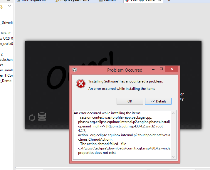

Anyway, a few minutes trying to download and install the compiler tools later, an error seems to occur and the details are shown in the following picture:
Is there anything I can do to fix this issue? And is this the correct way to install the MSP432 compiler tools? I'm making the assumption, probably in a wrong way, that those are included in the MSP430 compiler tools updates I'm trying to download, since I couldn't find them listed in any of the sites available under the "Install new software" utility.

    Unlike the MSP430, the MSP432 is an ARM based device (Cortex M4). So you'd actually want to get the ARM Compiler updates, not the MSP430 ones. I'm not sure if that will fix what appears to be permission error but if you can give it a try and let me know, that'd be great.

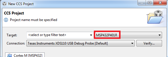

  • I also want to confirm if you have MSP432 device support installed. When you go to the new project wizard, do you have the following option in the drop-down target list?
