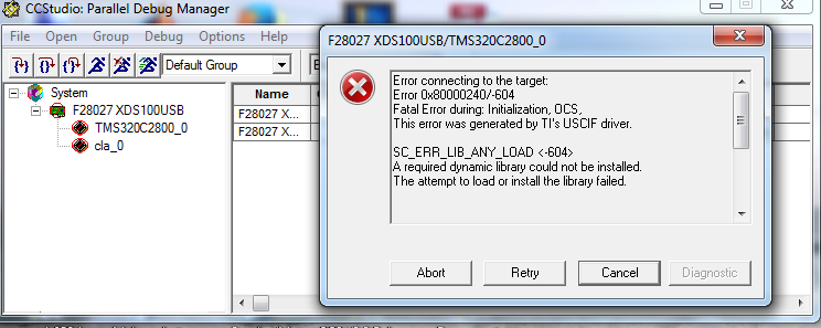

Now, recognize the serial port but appear a strange warning than close the ccs
i install the ccs 6.1 and unistall again, i unistall and install the ccs 3.3 and now only appear that warning
i find a similar pic
But that say that i need install the ccs 4.1 and i cant find, now only appear thar warning

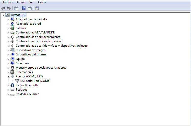

    the PC of my partner work good with ccs 3.3 and simulink, but my pc have that problems:
    -driver of port com5 (i fix installing ccs 6.1)

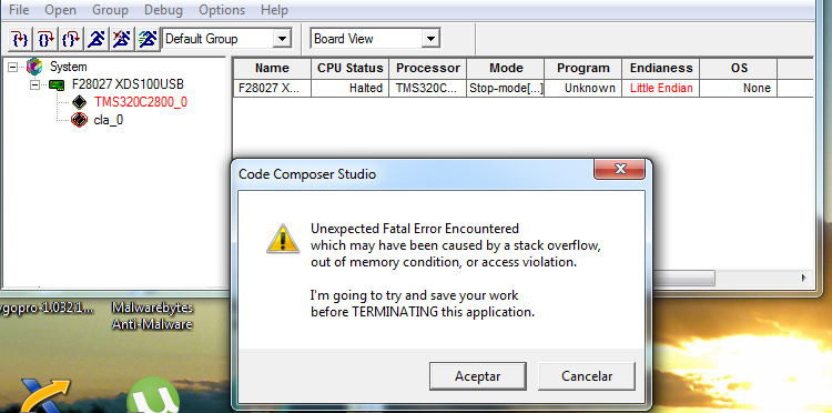

    -when i try to conect the target in ccs 3.3 appear that warning than close the program

    now, dont care if i uninstall or install the ccs versions of 4.1 or 6, the warning appear in the ccs 3.3 and close the program, i mean, the yellow warning that say "something is corrupt, i will try to save the workspace"

  • I forgot, that warning only appear when i try conect the target in the ccs 3.3, when i do
    -Debug
    -Conect... then say "halted" and appear the "warning" saying that "something is corrupt, i will try to save the workspace"
    -the ccs just close.
    im sure that i conect good in "setup css 3.3", xds100 emulator, F28027...

  • You are using the latest version of CCS.
    However, I just realized (looking at your other thread) that you are using XDS100v2. This emulator is not supported with CCSv3. Only the XDS100v1 is supported with v3. You will have to acquire and XDS100v1 if you wish to use CCSv3. Sorry
