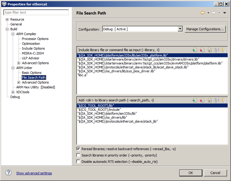

I have installed CCS6.1 and AM335X SDK 1.1.0.8 and TIRTOS 2.0.1.23 and XDCTOOLS 3.31.0.24 on Win7-64.
I have tried importing various example SDK projects into a new workspace, define the missing IA_SDK_HOME path symbol that is always missing for some reason in imported projects, but still cannot get any examples to build, it appears I am missing a library as symbols remain missing after linking, but there is no indication what library it might be. I am using the unmodified default linker cmd file. I have done this same thing numerous times in CCS5.5 without issues.
below is an example project build output for the Ethercat example project, but I get similar errors for other SDK example projects.

"D:/TI_CCS6/ccsv6/tools/compiler/ti-cgt-arm_5.2.2/bin/armcl" -mv7A8 --code_state=32 --abi=eabi -me -g --gcc --define=ECAT_LIMITED_DEMO --diag_warning=225 -z -m"ethercat.map" -i"D:/TI_CCS6/ccsv6/tools/compiler/ti-cgt-arm_5.2.2/lib" -i"D:/TI_CCS6/ccsv6/tools/compiler/ti-cgt-arm_5.2.2/include" -i"D:/TI_CCS6/am335x_sysbios_ind_sdk_1.1.0.8/sdk/platform/am335x/lib" -i"D:/TI_CCS6/am335x_sysbios_ind_sdk_1.1.0.8/sdk/os_drivers/lib" -i"D:/TI_CCS6/am335x_sysbios_ind_sdk_1.1.0.8/sdk/protocols/ethercat_slave/stack_lib" --reread_libs --warn_sections --xml_link_info="ethercat_linkInfo.xml" --rom_model -o "ethercat.out" "./tiescappl.obj" "./tiescutils.obj" "../am335x.cmd" -l"./configPkg/linker.cmd"  -l"D:/TI_CCS6/am335x_sysbios_ind_sdk_1.1.0.8/sdk/platform/am335x/lib/am335x_platform.lib" -l"D:/TI_CCS6/am335x_sysbios_ind_sdk_1.1.0.8/sdk/starterware/binary/armv7a/cgt_ccs/am335x/drivers/drivers.lib" -l"D:/TI_CCS6/am335x_sysbios_ind_sdk_1.1.0.8/sdk/starterware/binary/armv7a/cgt_ccs/am335x/evmAM335x/platform/platform.lib" -l"D:/TI_CCS6/am335x_sysbios_ind_sdk_1.1.0.8/sdk/protocols/ethercat_slave/stack_lib/ecat_slave_stack.lib" -l"D:/TI_CCS6/am335x_sysbios_ind_sdk_1.1.0.8/sdk/os_drivers/lib/sys_bios_driver.lib"

 undefined             first referenced
  symbol                   in file
 HOSTwrite             D:\TI_CCS6\am335x_sysbios_ind_sdk_1.1.0.8\sdk\examples\ethercat_slave\Debug\configPkg\package\cfg\ethercat_pea8fnv.oea8fnv
 __TI_decompress_none
 __TI_decompress_rle24
 __TI_zero_init
 __aeabi_uidivmod      D:/TI_CCS6/am335x_sysbios_ind_sdk_1.1.0.8/sdk/os_drivers/lib/sys_bios_driver.lib<osdrv_mcspi.obj>
 __aeabi_uldivmod      D:\TI_CCS6\am335x_sysbios_ind_sdk_1.1.0.8\sdk\examples\ethercat_slave\src\sysbios\sysbios.aea8fnv<BIOS.obj>
 _args_main            C:\ti\xdctools_3_25_03_72\packages\ti\targets\arm\rtsarm\lib\boot.aea8fnv<boot.oea8fnv>
 _nop                  D:\TI_CCS6\am335x_sysbios_ind_sdk_1.1.0.8\sdk\examples\ethercat_slave\Debug\configPkg\package\cfg\ethercat_pea8fnv.oea8fnv
 _register_lock        D:\TI_CCS6\am335x_sysbios_ind_sdk_1.1.0.8\sdk\examples\ethercat_slave\Debug\configPkg\package\cfg\ethercat_pea8fnv.oea8fnv
 _register_unlock      D:\TI_CCS6\am335x_sysbios_ind_sdk_1.1.0.8\sdk\examples\ethercat_slave\Debug\configPkg\package\cfg\ethercat_pea8fnv.oea8fnv
 abort                 C:\ti\xdctools_3_25_03_72\packages\ti\targets\arm\rtsarm\lib\ti.targets.arm.rtsarm.aea8fnv<System.oea8fnv>
 atexit                C:\ti\xdctools_3_25_03_72\packages\ti\targets\arm\rtsarm\lib\ti.targets.arm.rtsarm.aea8fnv<System.oea8fnv>
 copy_in               C:\ti\xdctools_3_25_03_72\packages\ti\targets\arm\rtsarm\lib\auto_init.aea8fnv<auto_init.oea8fnv>
 main_func_sp          C:\ti\xdctools_3_25_03_72\packages\ti\targets\arm\rtsarm\lib\boot.aea8fnv<boot.oea8fnv>
 memcpy                ./tiescutils.obj
 memset                D:/TI_CCS6/am335x_sysbios_ind_sdk_1.1.0.8/sdk/platform/am335x/lib/am335x_platform.lib<plat_utils.obj>
 strlen                D:/TI_CCS6/am335x_sysbios_ind_sdk_1.1.0.8/sdk/os_drivers/lib/sys_bios_driver.lib<osdrv_uart.obj>
error: unresolved symbols remain
error: errors encountered during linking; "ethercat.out" not built
