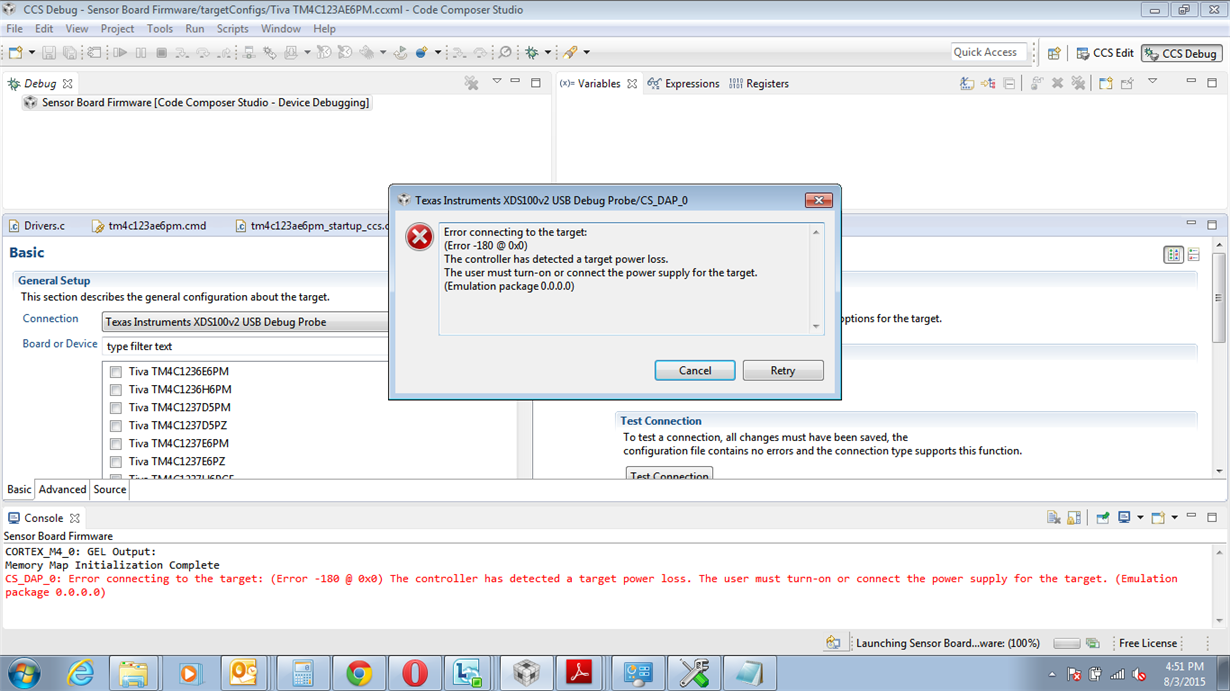

I am using a Tiva Tm4C123AE6PM uC with CCS 6 and XDS100v2.
When I connect a debugger to my custom board, I get an error saying target has no power (-180). I have connected the power and can see the voltages correct on a multimeter.
When I try programming another board from the same debugger and CCS, it does that correct.
Both the boards are identical as far as the processor and the 3v3 sections are concerned. Please advise what can be done.

  • Makarand,
    Would you mind copying the output text of the "test connection" button to a .txt file and attaching to this post? I just want to be absolutely sure we are talking about the very same error. Also, if the "test connection" does not show an error, can you send me a screenshot of the CCS screen?
    Given the same debugger works on another environment, I can't help but suspect something on the board is causing this, as the voltage detect threshold on the XDS100v2 is about 1.6V.
    I am pretty sure you already did this, but perhaps a voltage comparison between the working and non-working boards may help. Also, I wonder if somehow the core itself is not properly powered, despite the voltage is present on the device pin - in other words, the device itself may be faulty. Although this would throw a different error message than I believe previously, thus the screenshot and the test connection error would help with this.
    Unfortunately JTAG can only "see" so far into the system, therefore something that is caused by other factors may be perceived by the JTAG as having a different cause.
    Rafael
  • Hi Rafael,
    Here is the screen shot from CCS and the notepad file, Please check.
    Also, I have already tested the voltages on the two boards. They are not different than a few milivolts.
    The core voltage on the board which is failing to program is 1,2V.
    Thanks!
    Makarand
