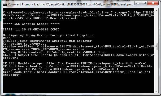

  • I'm having this error, can any one tell me what am I doing wrong?
  • Same problem than Leonardo, can you help me?
    The most common reason for that particular error is that the debugger failed to file the specified file in the specified location. Check to see if the file name and path is valid. The debugger is expecting a *.out file to load (in most cases). The error message shows what looks like a path to the project folder but not the *.out file. Check you script and make sure the file name is specified also.
    ki
  • I solve the error, I just changed the folder where *.out file was located (changed to desktop), and runs well.
