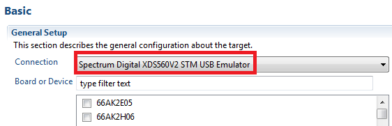

  • Martin,
    Martin H. said:
    [Start: Texas Instruments XDS560 Debug Probe_0]
    It looks like you selected the connection type "Texas Instruments XDS560 Debug Probe". This is the wrong connection type for your emulator. You need to select the 560v2 type for your emulator. For example, I have a XDS560v2 from Spectrum Digital and I have their drivers installed. So I use:
    In your case, you would need to use the connection type for SEED. If one does not show up in the drop down list, I would guess that the drivers did not install correctly or installed in the wrong directory (missing the xml files needed by CCS)
    ki
  • ki,
    you were right with the wrong directory.
    The manual is not very precise with the installation directory.
    This time I installed the software to c:\ti\ccs6\ccs_base.
    2 connections are offered now:
       SEEE XDS560V2 USB Emulator and
       SEEE XDS560V2 LAN Emulator
    I have chosen the 1st one. The Test Connection does not show any errors.
    Loading and stepping through the program is possible.
    Thank you for your help!
