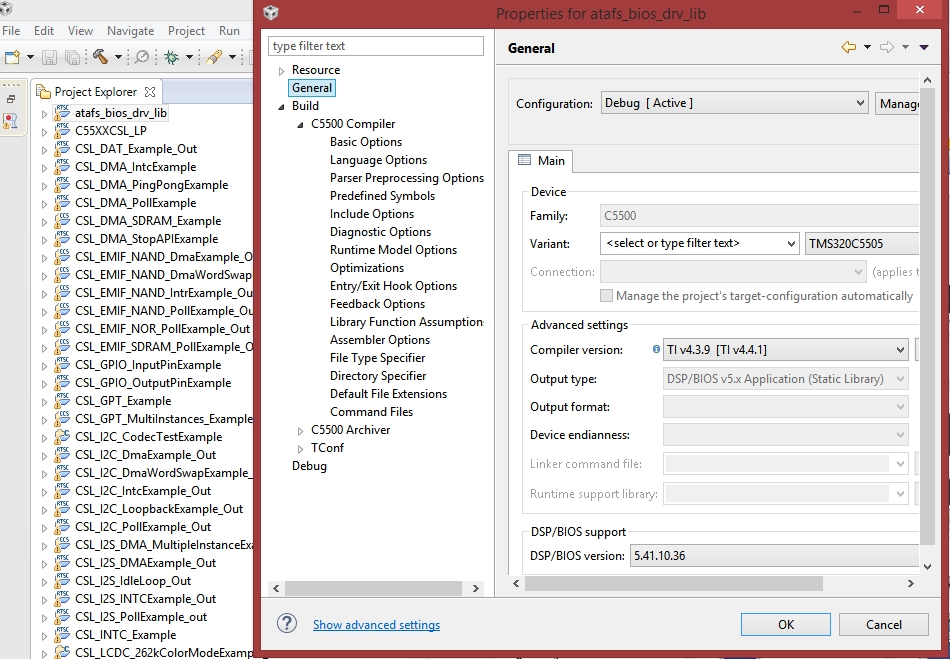

  • There is capture my desktop:
  • There is capture my settings, maybe this is too wrong settings:

    Keep in mind you are working with a version of CCS that was not used originally when the CSL package was created, therefore variations to the published process are happening.
    Timo Matalalampi said:
    I don't know which one is better, you said "select both the options "Copy Projects to workspace" and "Automatically import referenced projects..."." but installation guide at page 11 says "Leave the “Copy projects into workspace” box unchecked.
    I see the confusion this creates, but some older software packages used to present several problems when its projects were copied to the workspace, which prevented them from being properly built. When I tested the options I sent it with the project you mentioned these issues did not happen.

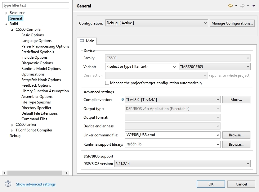

  • Hi!
    I got a compile exampleprogram , but next came to the following message: "C55xx: Error initializing emulator".
    My desktop capture:
    and Properties capture:

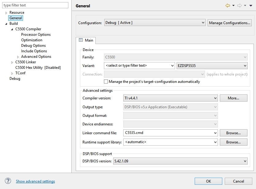

    I note that Variant is not correct: TMS320C5505 (EZDSP5535 can be found in the menu).
    I changed correct Variant:

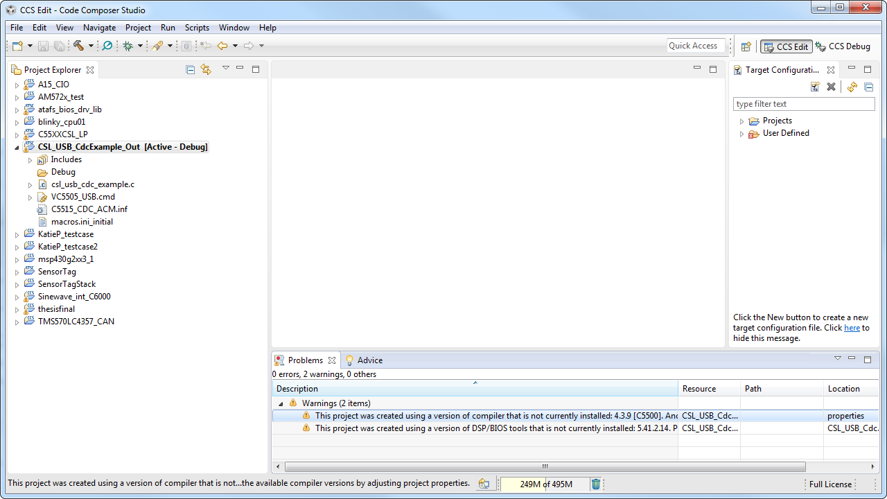

    and get warning: This project was created using a version of DSP/BIOS tools that is not currently installed: 5.41.2.14. Please install the DSP/BIOS tools of this version, or migrate the project to one of the supported versions.
    compiling and things just get worse:

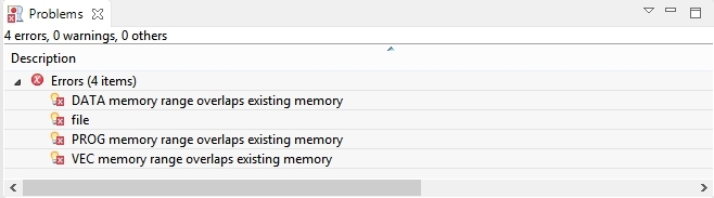

    build log:
    **** Clean-only build of configuration Debug for project CSL_USB_CdcExample_Out ****
    "C:\\ti\\ccsv6\\utils\\bin\\gmake" -k clean
    DEL /F  "CSL_USB_CdcExample_Out.out"
    DEL /F "csl_usb_cdc_example.pp"
    DEL /F "csl_usb_cdc_example.obj"
    'Finished clean'
    **** Build Finished ****
    **** Build of configuration Debug for project CSL_USB_CdcExample_Out ****
    "C:\\ti\\ccsv6\\utils\\bin\\gmake" -k all
    'Building file: ../csl_usb_cdc_example.c'
    'Invoking: C5500 Compiler'
    "C:/ti/ccsv6/tools/compiler/c5500_4.4.1/bin/cl55" -v5505 -g --include_path="C:/ti/ccsv6/tools/compiler/c5500_4.4.1/include" --include_path="C:/ti/bios_5_42_01_09/packages/ti/bios/include" --include_path="C:/ti/bios_5_42_01_09/packages/ti/rtdx/include/c5500" --include_path="C:/CSL/c55xx_csl/inc" --include_path="C:/CSL/c55xx_csl/ccs_v5.0_examples/usb/CSL_USB_CdcExample/Debug" --define="_DEBUG" --define=c5535 --diag_warning=225 --ptrdiff_size=16 --algebraic --asm_source=algebraic --asm_listing --preproc_with_compile --preproc_dependency="csl_usb_cdc_example.pp"  "../csl_usb_cdc_example.c"
    'Finished building: ../csl_usb_cdc_example.c'
    'Building target: CSL_USB_CdcExample_Out.out'
    'Invoking: C5500 Linker'
    "C:/ti/ccsv6/tools/compiler/c5500_4.4.1/bin/cl55" -v5505 -g --define="_DEBUG" --define=c5535 --diag_warning=225 --ptrdiff_size=16 --algebraic --asm_source=algebraic --asm_listing -z -m"CSL_USB_CdcExample_Out.map" --stack_size=0x200 --heap_size=0x400 -i"C:/ti/ccsv6/tools/compiler/c5500_4.4.1/lib" -i"C:/ti/ccsv6/tools/compiler/c5500_4.4.1/include" -i"C:/ti/bios_5_42_01_09/packages/ti/rtdx/lib/c5500" -i"C:/ti/bios_5_42_01_09/packages/ti/bios/lib" -i"C:/CSL/c55xx_csl/ccs_v5.0_examples/C55XXCSL_LP" -i"C:/CSL/c55xx_csl/ccs_v5.0_examples/usb/CSL_USB_CdcExample" -i"C:/ti/ccsv6/tools/compiler/c5500_4.4.1/lib" --reread_libs --warn_sections --xml_link_info="CSL_USB_CdcExample_Out_linkInfo.xml" --rom_model --sys_stacksize=0x200 -o "CSL_USB_CdcExample_Out.out" "./csl_usb_cdc_example.obj" "../C5535.cmd" "../VC5505_USB.cmd"  -l"Debug/C55XXCSL_LP.lib" -l"rts55x.lib" -l"libc.a"
    <Linking>
    "../VC5505_USB.cmd", line 8: error: VEC memory range overlaps existing memory
       range DARAM0
    "../VC5505_USB.cmd", line 9: error: DATA memory range overlaps existing memory
       range DARAM0
       range DARAM1
       range DARAM2
       range DARAM3
       range DARAM4
       range DARAM5
       range DARAM6
       range DARAM7
       range SARAM0
       range SARAM1
       range SARAM2
       range SARAM3
    "../VC5505_USB.cmd", line 10: error: PROG memory range overlaps existing memory
       range SARAM4
       range SARAM5
       range SARAM6
       range SARAM7
       range SARAM8
    fatal error: file
       "C:/CSL/c55xx_csl/ccs_v5.0_examples/C55XXCSL_LP/Debug/C55XXCSL_LP.lib<csl_cd
       c.obj>" has a Tag_Memory_Model attribute value of "2" that is different than
       one previously seen ("1"); combining incompatible files
    >> Compilation failure
    gmake: *** [CSL_USB_CdcExample_Out.out] Error 1
    gmake: Target `all' not remade because of errors.
    I am even more confused now. Getting this work looks really hard.

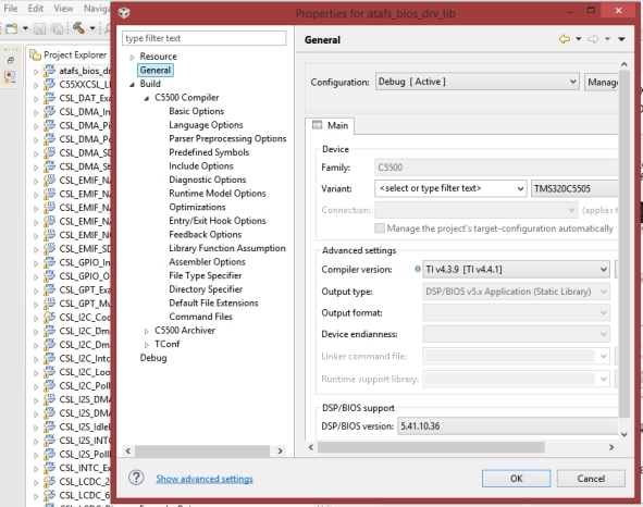

  • I cant' get changed dsp/bios to older version (5.42.1.09 -> 5.41.2.14) and compiler ver. to 4.3.9. Maybe this would have helped.
    I must be try to something else.
    Timo
    The device variant on this screen indicates the original project was designed for the C5505. However, the build options on the C5500 Compiler and Linker trees are ultimately responsible for the code output. In other words, changing this option is probably not a requirement for the project to work in your device, but if you need additional clarification I would strongly suggest you to post this issue in the device forum, as this software package was designed by them.
    I changed correct Variant: and get warning: This project was created using a version of DSP/BIOS tools that is not currently installed: 5.41.2.14. Please install the DSP/BIOS tools of this version, or migrate the project to one of the supported versions.
    I see this warning in the Problems view even before changing the device variant on my projects. I also see a warning about the compiler tools as well (see screenshot below). This is explained by the fact you are using CCSv6 instead of the one used when the project was created.
    If you want to install the previous DSP/BIOS release on your CCSv6, go to the CCS App Center (menu View --> CCS App Center) and scroll down to "Standalone Tools". There is a box with the DSP/BIOSv5 download information there.
    Also, if you want to install the original compiler version (4.3.9), download it from this page and check this short clip to learn how to point to it on your project.
    A change to the device variant is makes CCS to provide all resources to support the new device - it will add some device specific compiler and linker options and a linker command file suitable for the new device. In your particular case, the added linker cmd file <C5535.cmd> is conflicting with the original <VC5505_USB.cmd>. In this case, you can simply right-click on the <C5535.cmd> file and either select Exclude from build or Delete.
