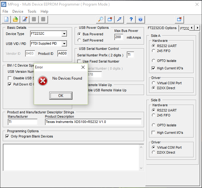

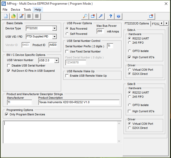

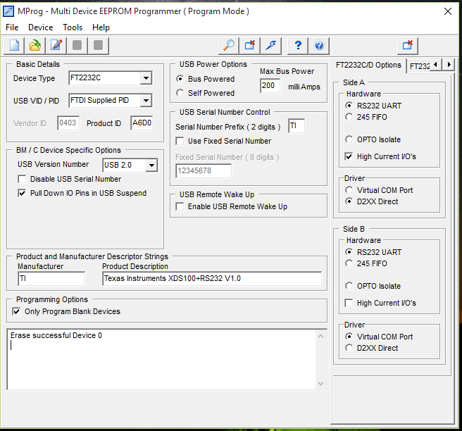

Current Problem: When following the steps to re-program the EEPROM on the XDS100v2, the re-program fails.  This occurs after the initial open of the XDS100_wUART.ept file, the scan and the erase.  If I read the device after the erase the device shows FF for all locations.  When I try to re-program it fails and outputs an error message stating no devices found.  Below are screenshots from the initial scan, the erase, the read to show FF and the failure to re-program.

    The detail that strikes me is the fact you selected a FT2232C, while the XDS100v2 design uses a FT2232H. This alone may be the cause of the programming failure.
    I send attached the template for my BH-USB100v2 debugger, so you could try to bring yours back to life.
    One additional detail is that FTDI is not supporting MProg anymore, but I am not sure if that is causing the trouble (I never had any trouble with either this or FTProg).
    Hope this helps,
    Rafael

    I just wanted to make a comment that the selected FT2232C was not selected by me. All settings within MProg are not changeable once you load the .ept file. These selections are loaded with the file and I did not change anything from the posted instruction set, simply followed them.
  • Rafael,
    I was able to use your file and successfully reprogram the XDS100v2.
    Thanks for your help and support.
