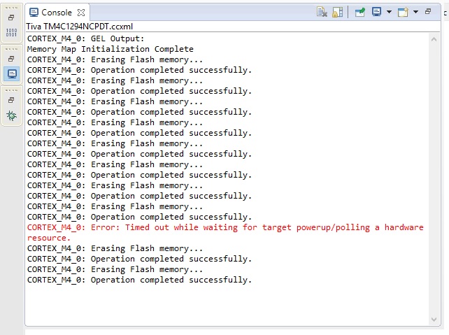

    Does the CCS lock-up happen when the Flash is being erased or when it is being programmed? To isolate this further, you can launch the debugger manually (instead of clicking the Green bug button to Debug), then connect to the target, and then go to the On-Chip Flash Tools to manually erase the flash, followed by manually loading the program using the menu menu Run --> Load --> Load Program.
    Once you have isolated the step in which it locks up, then please try to capture the debug server log and send to us for analysis.
  • AartiG
    Good afternoon.
    CCS locks when it is being programmed.
    I did debug manually, as you told, and erase and programming were done successfully but with some warnings:

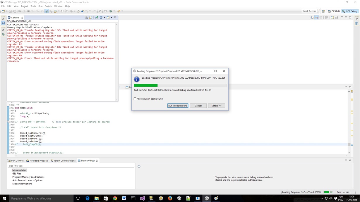

    But, when I try to use the green bug icon, the locking issue appears:
    I need to disconnect the USB cable to power-off the board to resume.

  • Hi AartiG
    Reading the posts you linked, I saw that Clark Leach said that Stellaris In-Circuit Debug Interface doesn't like USB hubs.
    In fact, deplugging my TM4C1294XL board from my USB HUB and plugging it directly to a PC USB port, the locking issue JUST DISAPPEAREAD.
    So, my conclusion is that STELLARIS IN-CIRCUIT DEBUG INTERFACE it is not 100% compatible with USB HUBs. Perhaps is it draining more current than the USB HUB can supply? In my case, I am not using its power supply, due conflict with internal +5VUSB of the PC power supply ( lack of a diode ).
    Problem solved.
