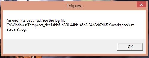

    When using the 'Windows->Preferences->Code Composer Studio->RTSC->Products '  after clicking 'OK' to exit the screen, i get the following message
    An error has occurred. See error log for more details.
    org/eclipse/osgi/framework/internal/core/BundleContextImpl
    I dont know where the error log is located

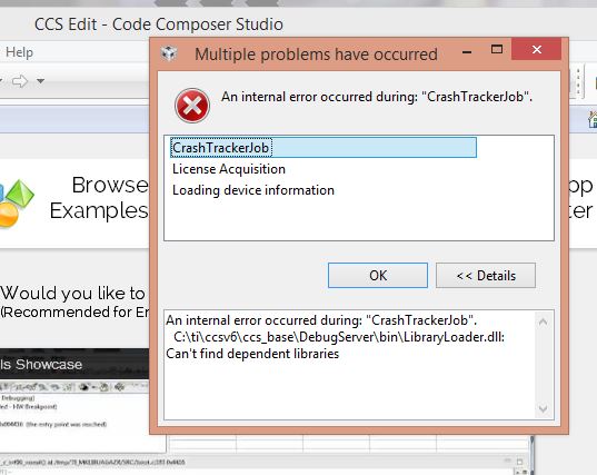

  • Hi Danish,
    The installation stopped while installing a exe file during the installation.
    I was working with MSP USB  microcontrollers for quite some time and i have installed software packages like TouchPro, Ware, etc.... In order to install TiVA I need to reinstall the software after uninstalling deleting all Texas instruments packages. I did so afterwards found out that the workspace link was causing  a failure in installation so i moved the workspace folder under a another folder. Then again ran the installation and this time it stopped on installing exe file.
    I was able to install CCS on a another machine to carry out my work.
    Jose Thomas

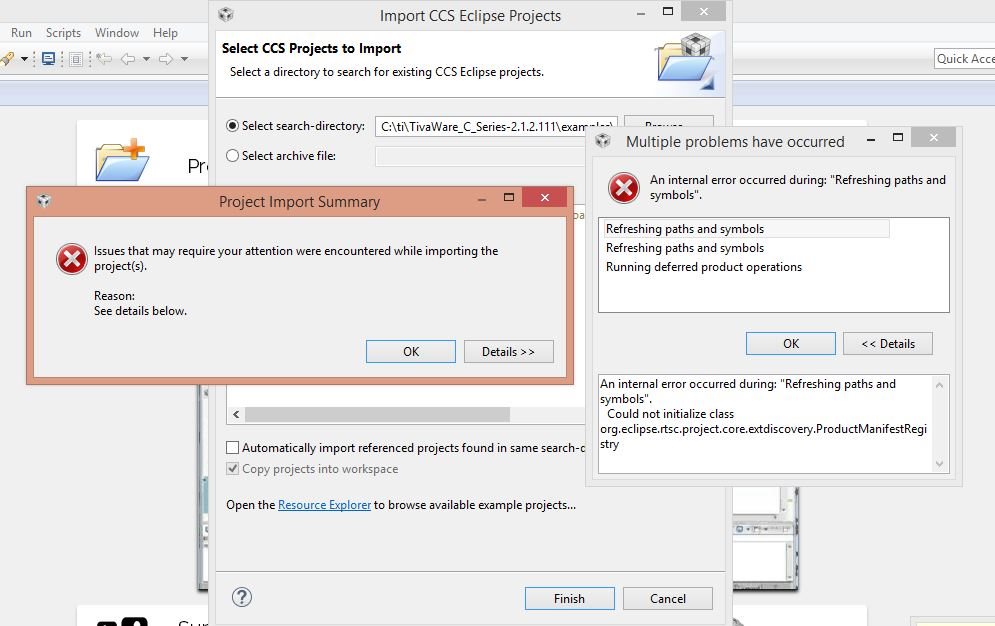

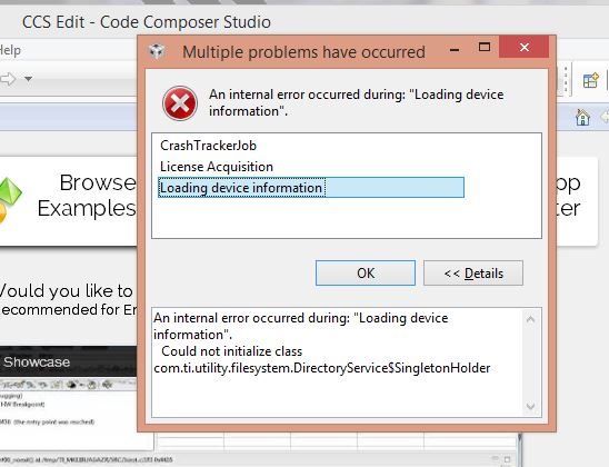

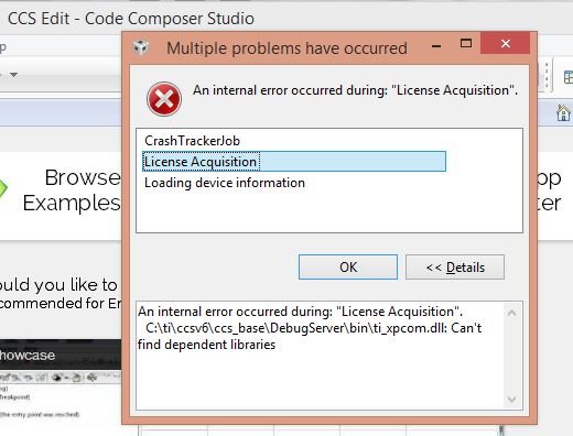

  • i am attaching all log files in zip format.And images showing error messages.
    Please give me solution to this problem.

    These errors are prompting at every start of CCS.
    This was at the time of building the example code of blinky.
    this error was prompt at the installation time.
  • Sir.
    I solved that errors.You just have to install some missing DLL files of 32 bits.
    Alternatively you can install x64 and x86 MSVC redistributable from Microsoft site if your PC is 64 bit.
