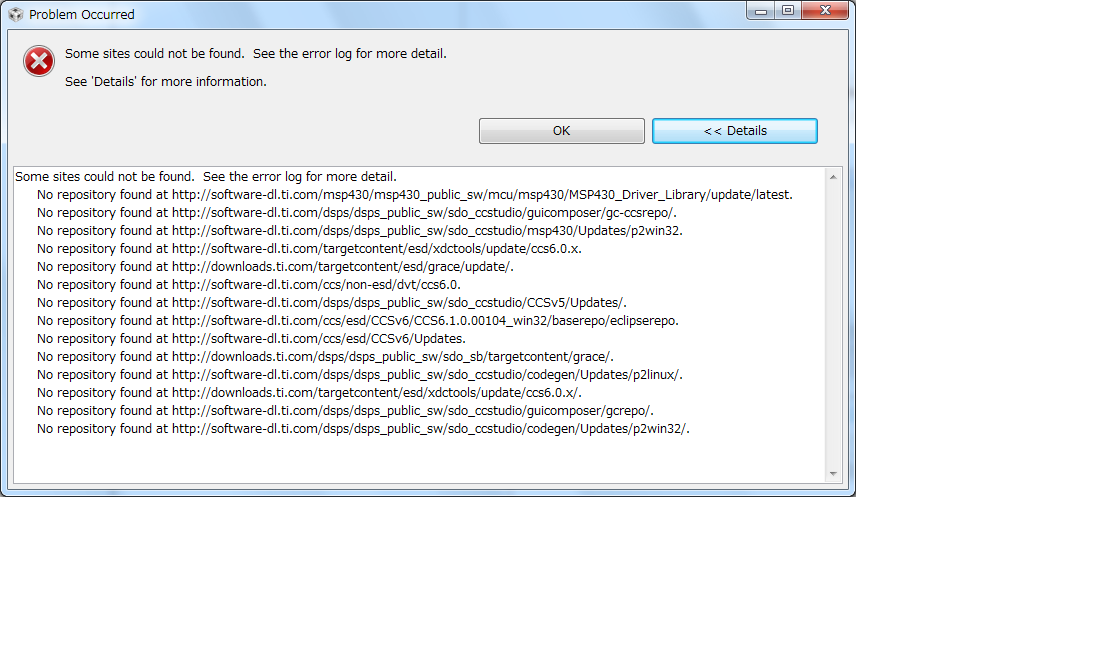

I updated Code Composer Studio Ver.6.1.0. when looking for updates (menu Help --> Check for Updates) the error "No repository found" can appear. Some sites could not be found. When I click details, I get a list of "No repository found" at a whole bunch of software-dl.ti.com addresses. Per Troubleshooting CCSv6 Update features, I then tried to restore the list, download the attached file, and unzip to extract the .xml file. Then go to CCS menu Window --> Preferences --> Install/Update --> Available Software Sites, click on Import.
However,hasn't been resolved.
Any idea what is going on?

Can you post the exact error your seeing, or a screen capture, please?

Hi Sato,
Could you please try the following:
Go to Help-> Install New Software
Select the CCS v6 update from the drop down list.
Unselect the checkbox (right at the bottom of the screen) "Contact all update sites..."
Continue with the update.
If this works, shut down CCS altogether, restart it, and try your updates.
Danish
Hi Danish,
I tried your solution,but selected the CCS v6 update then Could not find "Code Composer Studio v6 Updates - http://software-dl.ti.com/ccs/esd/CCSv6/Updates". and "Next" is Invalid.

Hi Danish,
The result we came up with your advice about browser setting, I tried my browser update from IE8 to IE11.
As a result, This issue has been resolved.
