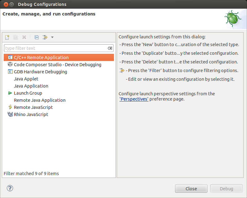

My PC had a Ubuntu 12.04, installed CCS 5.5. Now I would like to debug some C projects using GCC on Ubuntu OS. I find that CCS 5.5 has no such debug options for gcc on Ubuntu, see below picture please.

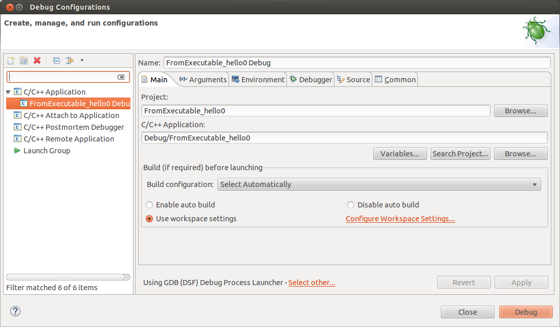

Then, I download an Eclipse CDT for C/C++, which has an option: 'C/C++ Application' under 'Debug Configuration'. That is what I want and I can debug a general C/C++ project.

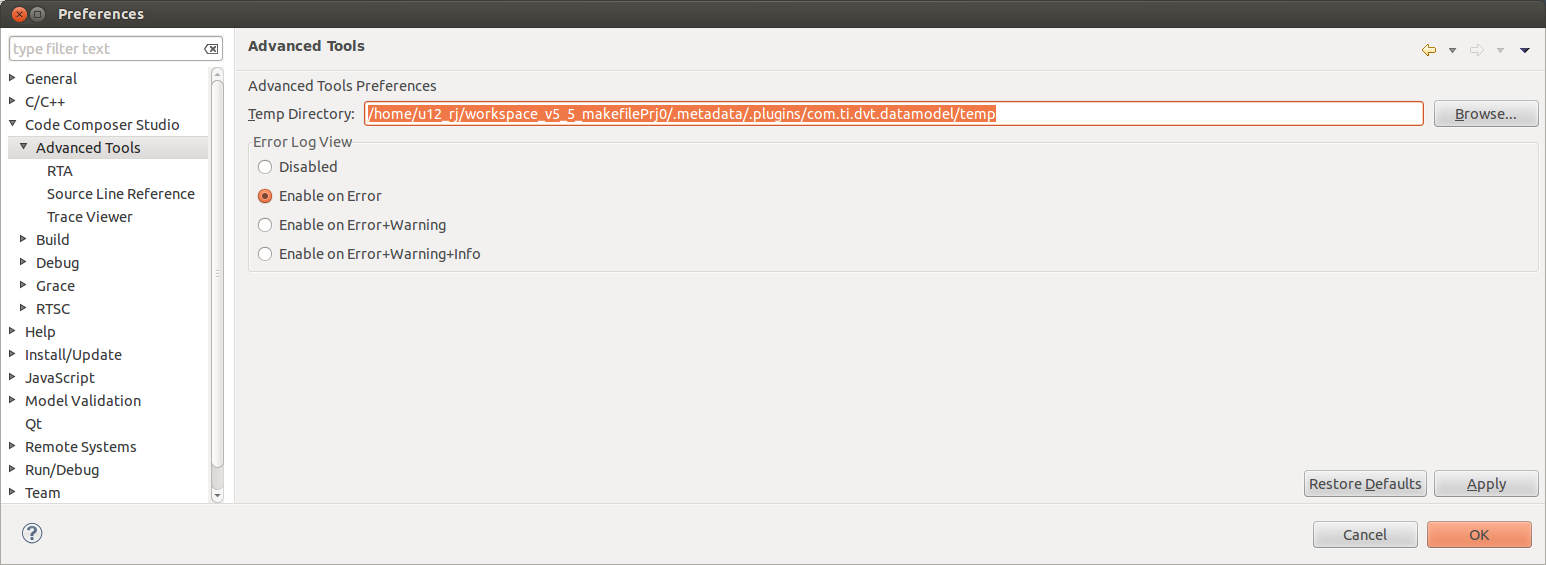

    From the following picture, it is found that CCS uses standalone C project settings, (but I don't know how to correct it).
    Path: '/home/u12_rrj/workspace_v5_5_makefilePrj0' is a standalone C project (not CCS project).
    It looks like both Eclipse using the save project settings, but I don't know how to keep them separately, i.e. CCS calls CCS projects, while standalone Eclipse calls its C projects.
    In CCS open Window -> Preferences. Under General -> Capabilities enable "CDT GDB Debugging". Apply this change.
    The Debug Configurations should now have the ability to use the native GDB launch settings for "C/C++ Application", "C/C++ Attach to Application" or "C/C++ Postmortem Debugger".
