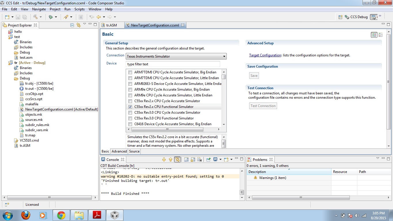

I want to simulate assembly codes for TMS320C54x in CCSv5. I successfully built the assembly code. Now I am stuck with debug section.
i have chosen texas instru. simulator in connection and c55xx rev 2.x CPU functional simulator in configuration
But when i am debugging code
in console window its giving error as "TMS320C55x: Can't Run Target CPU: ERROR : Ensure that you have proper reset vector in your program NOTE : Reset the target, reload the corrected program and continue execution "
